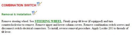

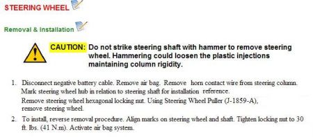

How do you change the multi function switch on a 2001 Chevy Cavilier? All other issues are ruled out. And now I will attempt to change this myself.
