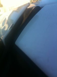

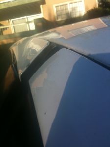

my 1999 chevy cavalier has a few problems ,
The car hesitates at higher speeds-the ac isnt working it just blows air-the temp gauge fluctuates like crazy-when my door is shut there is a big gap on the top right corner-the check engine light turned on around the same time the car started to hesitated-my low coolant light is on but the coolant isn't low
The car hesitates when i drive more than 45mph. This was happening before but stopped after we got the fuel pump changed
I've been trying to change almost every little thing on this car because the miles are so high and everything is bound to get busted soon
[img:e7a89f1dbd]http://www.2carpros.com/forum/automotive_pictures/581188_iphone_108_125_1.jpg[/img:e7a89f1dbd]
[img:e7a89f1dbd]http://www.2carpros.com/forum/automotive_pictures/581188_iphone_108_123_1.jpg[/img:e7a89f1dbd]

as far as the gap on the door goes, roll the window down, put your knee into the inside of the door, and pull the top... should bend it back to stock form... looks like you locked your keys in the car, and someone used an airbag to wedge the door open... now for the hesitation, did they replace the fuel filter when they did the pump? and I need to know what code, or codes come from the check engine light being on... bring it to your local parts dealer, they should scan it for free...
