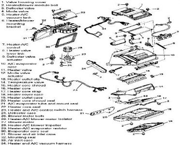

I think we have narrowed the problem down to the heater core. After pressure testing the cooling system, no obvious leaks, or leaking occurred.
When the heat is turned on, the windows fog up and you can smell the coolant in the car. But, there are no obvious leaks inside the car, and the carpet isn't saturated with moisture, or even damp for that matter.
I'm looking for a professional opinion to acknowledge whether or not I have correctly identified the cause of the loss of coolant, with the symptom of my car overheating.
If it is in fact the heater core, it would be great if you--responding to this help ad - could provide instructions on how to perform such a repair job. Thanks!

The symptoms you have described are indeed that of a faulty heater core. Replacement procedures are below for your vehicle's heater core..
REMOVAL:
Disable the SIR system, as outlined in this section.
Disconnect the negative battery cable.
Properly drain the cooling system.
Raise and safely support the vehicle.
Detach the heater hoses from the heater core.
Carefully lower the vehicle.
Remove the instrument panel.
Remove the DERM with the attaching bracket.
Detach the heater core cover.
Unfasten the heater core mounting clamps, then remove the heater core.
((( Exploded view of the heater core and related components )))
https://www.2carpros.com/forum/automotive_pictures/261618_Noname_472.jpg

Let me know if you need further assistance..
