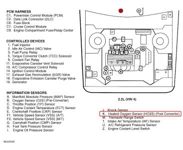

I have a 98 cavalier and it started losing acceleration power, I would press the gas and it wouldn't go. I took it to auto zone and they ran a diagnostic on it and it said that the o2 sensor in Bank 1 Sensor 2 could be bad or had a bad connection. According to the readout they gave me it should be before the cat converter but I can't seem to find it. Any help would be appreciated.

Before going any further, I need the EXACT code number to make sure you get the right sensor.

I'm not sure exaactly what code i'm looking for, on the slip they gave it me says. H02S 12 Heater condition (heated oxygen sensor Bank 1 Sensor 2)

It should be on the slip. It will start with a "P" followed by four-digit number. These are some of examples for heated oxygen sensor for Bank 1 Sensor 2.
P0036 HO2S Heater Control Circuit (Bank 1 Sensor 2)
P0037 HO2S Heater Control Circuit Low (Bank 1 Sensor 2)
P0038 HO2S Heater Control Circuit High (Bank 1 Sensor 2)
P0139 02 Sensor Circuit Slow Response (Bank 1 Sensor 2)
P0140 02 Sensor Circuit No Activity Detected (Bank 1 Sensor 2)
P0141 02 Sensor Heater Circuit Malfunction (Bank 1 Sensor 2)

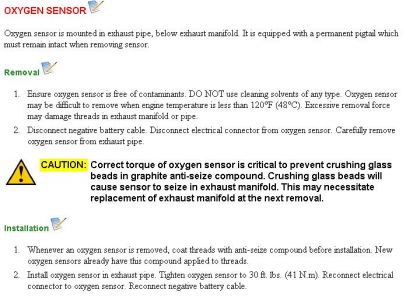

Description:
Bank 1: Bank means cylinder head. In your case, you only have one bank (Bank 1). Locate your exhaust pipe. Sensor 1 is the one by the exhaust manifold and sensor 2 is the one after the catalytic converter. Sensor 1 sometimes is also called pre-cat sensor, and Sensor 2 called post-cat sensor. You have go under the car, locate the cat in the exhaust pipe, and you should see a 4-wire sensor attached to the exhaust pipe.
