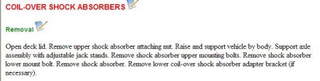

What is needed to change rear struts?
Thursday, January 28th, 2010 AT 8:46 AM
BLUELIGHTNIN6
MECHANIC
16,542 POSTS
Should have coil-overs on rear, not struts..
