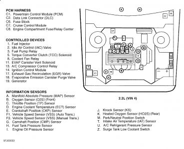

What would cause your oil pressure light to come on? It just started doing that, I brake then it comes on, I accelerate it goes off, oil is fine, except that light just showed up, its currently off right now but I would appreciate any input

It could be a bad oil pressure sender, or the oil pump pickup may have worked loose.
I would change the sender first, if problem persists, remove oil pan and check pump pickup.

Could you explain on where these parts I have to check are located and what needs to be done, is it an expensive job or is the car worth fixing

Normally I would say it was a faulty oil pressure sender, but since you say it goes off when you accelerate, it sounds more like a oil pump pickup in crankcase.
Oil pressure sender is on left rear of engine, remove connector, clean and reconnect, if problem persists, have oil pressure tested with mechanical gauge, if OK, but problem persists upon stopping and acceleration, then oil pump, or pickup, or possibly the oil pan baffles are bad.
The question of cost vs. value of car is a question only you can answer.
If you do the work yourself, you maybe looking at $400-500.
If a shop has to remove pan and oil pump, then double the cost.

So what would happen if these things are not repaired?
Sunday, October 11th, 2009 AT 2:15 PM
MMPRINCE4000
  • 8,548 POSTS
If it is a bad gauge sender, then nothing would happen.
If the oil pressure is in fact low, you will starve the engine of oil and eventually cause premature bearing failure, main and cam bearings in particular.
