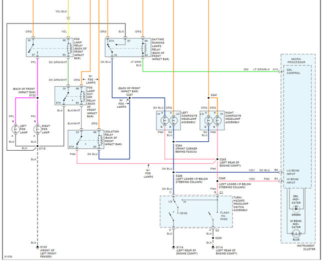

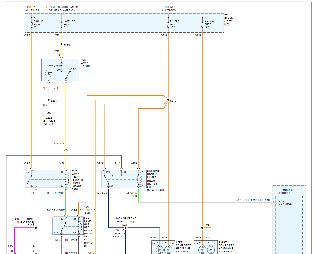

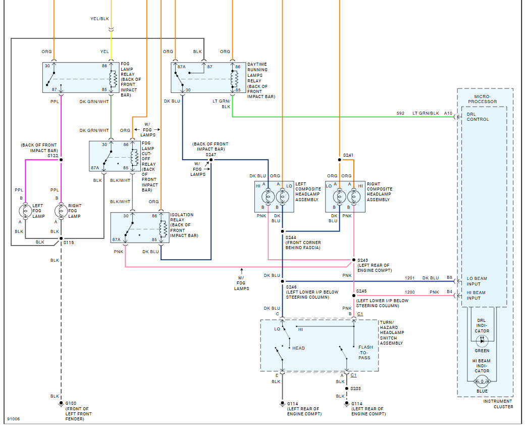

My driver side headlight doesnot work. There is power to the fuse box but none to the spot where you plug in the bulbs. Don't know if you have any ideas or DETAILED wiring diagrams. The ones we have found don't give any details. Thank you.

Make sure it is grounded properly. (check the post below for the wiring diagrams you can see)
https://www.2carpros.com/forum/automotive_pictures/261618_Noname_344.jpg
https://www.2carpros.com/forum/automotive_pictures/261618_Noname2_96.jpg
Picture a little too small? Give me your email address and I will send you the diagram via email. This will allow you to use a ZOOM command to better view the diagram.

Here are the headlight wiring diagrams. Check out the images (below). Let us know how it goes.
