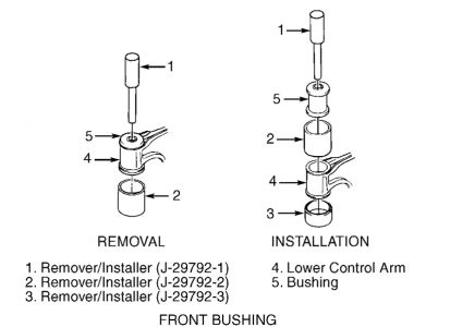

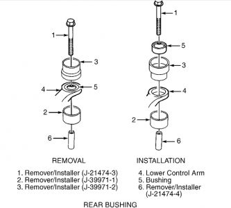

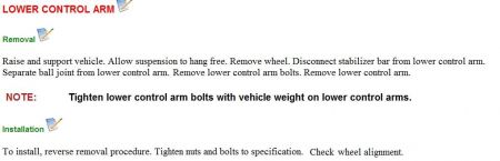

How to change a control arm bushing?
Friday, August 20th, 2010 AT 1:56 AM
BLUELIGHTNIN6
MECHANIC
16,542 POSTS
Have to use special service tools. first remove control arm then use tools as shown below..
