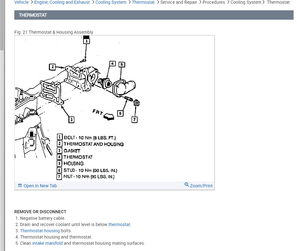

How do you change the thermostat on a 1995 Chevy Cavalier?
Friday, October 31st, 2008 AT 6:12 PM
MECHANIC
18,907 POSTS

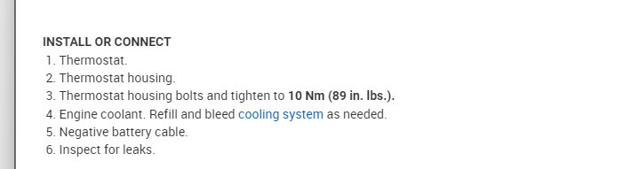

I will attach the process from the manual below. However, here are some guides that will help with this:
https://www.2carpros.com/articles/how-an-engine-thermostat-works
Plus, here is a video that will help with a different Chevrolet. Clearly not the exact same process but it has some good visual tips.
https://youtu.be/jhXBAtcutQo
Please let me know what questions you have with the info below.
Let us know what you make out.
Thanks
