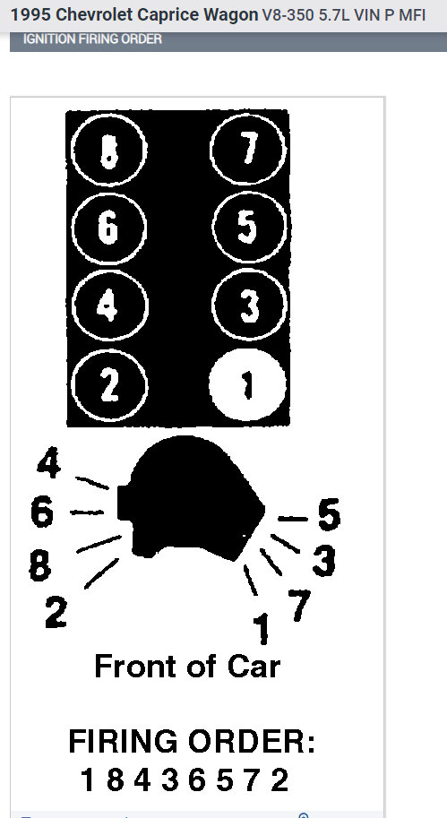

What is the wire order on a 1995 chevy caprice wagon coil pack

The firing order for this caprice with the 5.7L is :1 8 4 3 6 5 7 2
I have attached the diagram that shows cylinder location and the plug wire location on the distributor cap.
