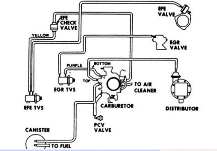

Looking for a diagram of the vacuum lines from carburetor to what they attached to on the engine?

Welcome, I found the above info at the autozone site.
