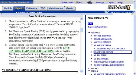

I bought a 92 camaro that hadnt been started in 6 years. It took some work but I got it running. It had no power and the exaust smelled like rotton eggs. I replaced the cat converter with a direct fit replacement. The car started and then started surging from 1000rpm to 100rpm over and over for a few seconds then died. If I keep trying to get it to start it diles real rough for a second then dies and sounds like its spitting back through the throttle body. I have replaced the ECM, EGR, TPS, MAP, Idle controll valve, Oxygen sensor, and the Air intake temp sensor. My code reader doesnt show any codes stored. The car idled fine when I drove it into the shop and replaced the cat, What could the problem be? Someone please help me!
Tuesday, September 24th, 2019 AT 7:22 PM (Merged)
  • 75,992 POSTS
Start by checking the fuel pressure-if its okay-check the ignition timing should be 0/TDC follow procedures below and also recheck the IACV and TPS
Also check the EGR and PCV valves
https://www.2carpros.com/forum/automotive_pictures/12900_est_2.jpg
Here's how to clean the IAC valve:
Disconnect the air intake ductwork from the throttle body.
Start the engine, then increase and hold the idle speed to 1,000 to 1,500 rpm.
Spray the throttle cleaner or engine cleaner into the throat of the throttle body, aiming for the idle air bypass port (usually located on the side or top of the throttle body opening). Give this area a good dose of cleaner (about 10 second's worth).
Turn the engine off to allow the cleaner to soak into the IAC passageway.
Wait about three minutes.
Restart the engine, rev and hold at 1,000 to 1,500 rpm, and repeat the cleaning process again.
Turn the engine off again, and reattach the air intake ductwork to the throttle body.
Start the engine and rev and hold to 1,500 to 2,000 rpm until no white smoke is coming out of the exhaust pipe

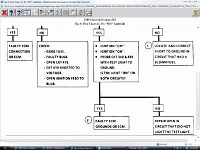

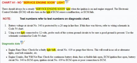

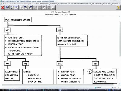

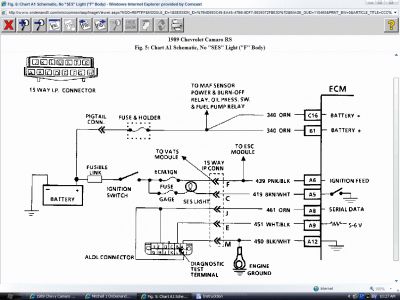

I have 89 camaro whats the next step if the service light dont worrk and checked the bulb it works?
Tuesday, September 24th, 2019 AT 7:23 PM (Merged)
MERLIN2021
  • 17,250 POSTS
Usually turns out to be a bad fuse, or connection...
https://www.2carpros.com/forum/automotive_pictures/62217_SES_Lighta_1.jpg
https://www.2carpros.com/forum/automotive_pictures/62217_SES_Lightb_1.jpg
https://www.2carpros.com/forum/automotive_pictures/62217_SES_Lightc_1.jpg
https://www.2carpros.com/forum/automotive_pictures/62217_SES_Lightd_1.jpg

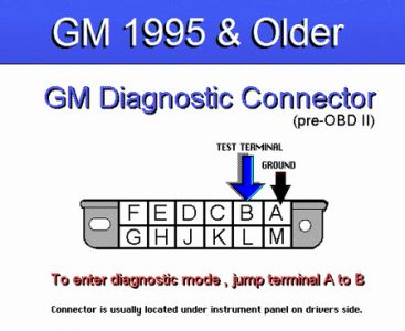

I'm trying to get my son's car smogged and the diagnostic will not send any signal to a scanner. We have replaced the computer and had a friend check it with his scanner and it still won't read. Do you think it is the PROM or poss something else. The check eng light flashes very fast and the car's idle is too high and using too much fuel. ( You can smell it)
My son bought the car last year and knows nothing about working on vehicles. I know a little, but not about vehicles with computers. The veh has been sitting in my driveway for the last 6 months because it won't smog and the tags are expired. Please help get this car out of my driveway.

JAZZGIRL23
I appreciate your answer about the idle, but it did not answer the orginal question of the computer not sending any thing to a scanner. We have replaced the computer but not the prom. I don't know if the prom was working before my son bought it. The check eng light has been blinking since he bought it. The first time he tried to get it smogged the scanner at the smog place could not read anything.

  • 75,992 POSTS
Your engine management system is OBD1 -try jumping A to B at the ADLC. Should read code 12 -if normal-The scanner might not be compatible.
