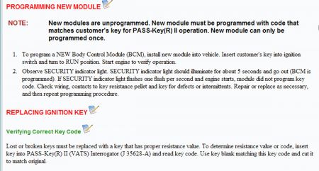

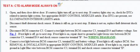

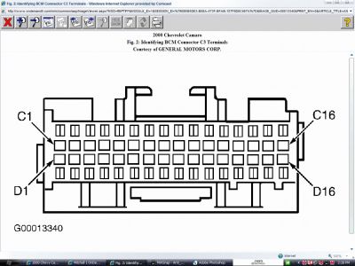

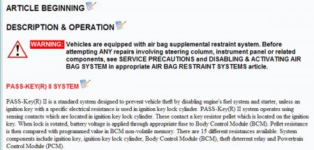

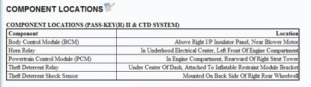

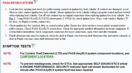

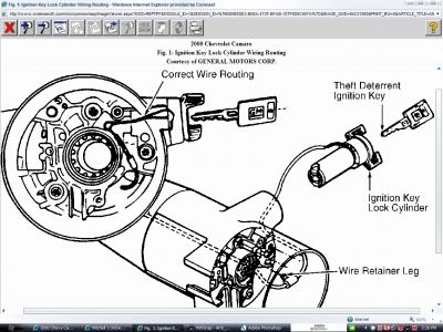

If someone out there can answer this question for me. I was wondering if the V8 camero has a Anti theft module, Anti - theft imobilizer and or Body Control Module. Does the car have one or two or have all three of these units? I know it has a BCM because I replaced it. Also does it have a Theft Deterent Relay and if so where is it. Thanks John

If this doesnt work, tell me what the security light is doing...
https://www.2carpros.com/forum/automotive_pictures/62217_Anti_Thefta_1.jpg
https://www.2carpros.com/forum/automotive_pictures/62217_Anti_Theftb_1.jpg
https://www.2carpros.com/forum/automotive_pictures/62217_Anti_Theftc_1.jpg
https://www.2carpros.com/forum/automotive_pictures/62217_Anti_Theftd_1.jpg
https://www.2carpros.com/forum/automotive_pictures/62217_Anti_Thefte_1.jpg
https://www.2carpros.com/forum/automotive_pictures/62217_Anti_Theftf_1.jpg
https://www.2carpros.com/forum/automotive_pictures/62217_Anti_Theftg_1.jpg

If you put the key in with the door open, does the chime sound? You can try the reprogram as noted in my post.
