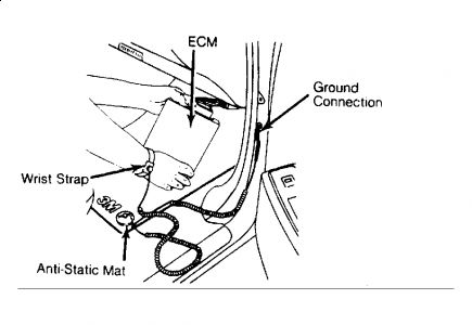

where is the ecm located?

Its located behind the dash on the passenger side. You have to remove the dash to get to it. Ive included a pic where you can see it. Its the silver box on the right hand side.

It is there all right BUT youdoNOT need to remove dash. Just remove the silence pad under dash and it is right there on A pillar. If you don't have ground strapes touch car body befor ethe ECM
