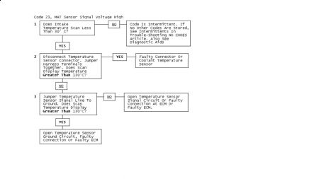

I am getting fire to the plugs and Im getting fuel at the rail is there a fuel pressure sensor. It gave the code 23 but I change that sensor and Im still having the problem
Wednesday, April 7th, 2010 AT 11:50 PM
INTERNETMECHANIC
  • 700 POSTS
Use a noid lite, check for injector pulse?
https://www.2carpros.com/forum/automotive_pictures/512072_mat_sensor_1.jpg
