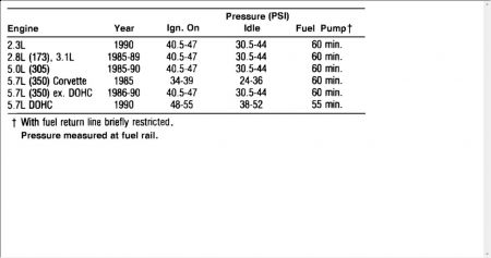

I have an 87 camaro 2.8 tpi that will start but wont stay running. I have checked and replaced the following. Its getting fire from coil to distributer to the plugs. It has full pressure for fuel on the rail at 45-47 PSI.
*THINGS REPLACED*
fuel pressure regulator.
fuel pump.
fuel pump harness.
solonoid.
battery Wires.
Fuel pump relay and fuse.
Gm Moduel (Ignition Module)

Recheck fuel pressure also try cleaning out the IACV and test the TPS and MAP sensors-See below
