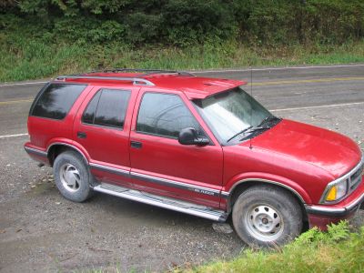

Please help! When our main headlights are on the blinkers won't work. Sometimes the right blinker does work when the headlights are on. During the day every once in awhile the blinkers stop working when I touch the breaks. Very confused and in need of advice.
Thanks!

Sounds to me you got a either ground problem, Or you got a shorted wiring some where, Also Have u got youre turn signal flasher relay tested or replaced. Also have you checked to make sure all youre light bulbs are working. Wouldnt hurt to check all the fuses as well.
Good Luck.
