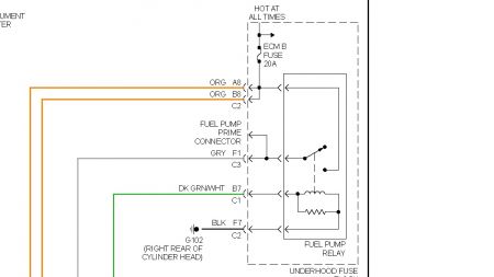

Fuel pump issues.Check engine light was on, after reading code, got a new gas cap and light went off. Two days later vehicle died. Fuel pump wouldn't come on. Got a new fuel pump and plugged both terminals in and now new one won't run. I only have a test light but I do get very weak power to one of the prongs on the pump terminal (not the sending unit terminal). Fuse not blown-ECM-B- and I did try switching around some relays with no success. I do have power and ground at relay as I checked it with key on and key off but I am not really sure what its supposed to be. Does the fuel pump need to be installed or grounded to work? I wanted to make sure it was going to function properly before I put it all back together.

You need to get a meter so you can read actual voltage. I've seen digital multimeter meters in discount stores, not very high, better than nothing. I don't know what testing you have done? I'd have to start from scratch. Make sure the battery has a full charge. Use a gage and check fuel pressure, engine cranking, right now, I don't care about the initial prime. Some of the national brand autostores used to loan out a fuel pressure gage, if you don't have one. Check for applicable trouble codes, at the least, you need an obd2 code reader. If it turns out the problem is other than a fuel issue, me and you are just spinning our wheels. A no load test on a fuel pump isn't worth much, I've seen pumps run just fine on the bench, wouldn't run with a load, though. In the diagram, the gray wire at the relay, carries voltage for the pump. If you unplug the relay and use jumper wire with inline fuse from battery to terminal for the gray wire, the pump should run, no need to use the key.

I'd get a digital multimeter. The dark green wire with white tracer at the relay is voltage for the coil side of relay. At initial prime, key on, no crank, the circuit would be hot only for a few seconds, then go dead without rpm signal. Engine cranking, that wire should be hot all the time, maybe low voltage because it comes from the computer, use digital multimeter to check.

Since you have a test light, let's start at the fuel pump relay. That will split it into four circuits. Attach the clip lead of the test light to the battery POSITIVE terminal, remove the fuel pump relay, and probe the four terminals in the socket. Don't push the probe in too far because it's easy to spread the terminals causing them to make intermittent contact. The test light should light up on two of those terminals. Sorry, my book doesn't show the pins or list the pin numbers.
Assuming you find good grounds on those two pins, move the test light's clip lead to the battery's negative post, then check for voltage at the two remaining terminals. One should have full battery voltage all the time. The other one gets battery voltage from the Engine Computer to turn on the relay. Voltage should appear there at some point; for sure during engine cranking, and possibly whenever the ignition switch is on.
If one of those powers or grounds is missing, we have to figure out which circuit it is and troubleshoot it. If you're missing one of the ground circuits, you can idnetify which one it is by observing if the test light reacts the same when the fuel pump is disconnected.

ok..just checked fuelk pump relay post...have 2 lit up while connected to positive..only one lit up while connected to negative side of battery. Car would start...took relay out..tapped it..put it in another way...not sure if this matters. car started!!!!! LOST

If you have the gray square relays with four terminals, it can be plugged in either way and work just fine.
It sounds like the two ground circuts are ok. One is the ground for the relay coil itself. The other one is reading to ground through the fuel pump motor.
That next test where you found battery voltage, if it is there all the time including when the ignition switch is off, that is the voltage supply for the fuel pump motor. The conclusion is the high-current circuit including the motor is ok. What appears to be missing is the 12 volt turn-on voltage for the relay. Since this is intermittent, a good suspect is a stretched terminal in the relay socket. Pushing the relay sideways while a helper cranks the engine might get it started, but it should also cause the pump (and engine) to quit while it's running.
The next thing is if the Engine Computer is intermittently not supplying the turn-on voltage. The question then becomes is the problem in the computer or is a signal to the computer missing. GM used a number of different circuits over the years. ALL Chrysler vehicles use one circuit that is very similar to one used by GM, and that involves the Engine Computer. Signals must be received from the crankshaft position sensor and camshaft position sensor. That tells the computer the engine is rotating and the fuel pump needs to be turned on. Other GM systems run the pump from a terminal on the oil pressure sending unit. (Low oil level can cause a stalling problem before the warning light turns on on those systems). With the Chrysler-type system, an intermittent sensor is a common cause of a no-start, but it is WAY more common for the problem to show up after the sensors get hot from normal engine operation.
What you must do next is test for voltage on that fourth terminal. It should appear for a second or two right after turning on the ignition switch, then it might go away until the engine is cranked. The first few seconds is to be sure fuel pressure is up and ready for starting. The voltage must be there again during cranking. Here's the key. If the voltage appears for the first two seconds, the computer is working. If it doesn't appear again during cranking, suspect the cam or crank position sensors.

THx for all your help. I trouble shot those wires..appear to be fine. So what Ive decided to do, since its an older blazer...spliced wire into power wire(gray) to the igition fuse...started right up. I guess Ill leave it like that...not having to worry about all the sensors ect. Thx again forall youre help.

The first thing to check is the 20amp ECMB fuse. If that is good, you will have to test for power going to the pump on the gray wire. There is also a fuel pump prime wire lead near the fuse box where you can power the pump itself for testing.

i have power at the 20 amp fuse (ecmb) but do not see a gray primer wire . where would that be located.i see it on the wireing diagram just not on the truck or sould i pull the relay out

It should be a short wire in the vicinity of the fuse/relay box. It's usually a red wire.
