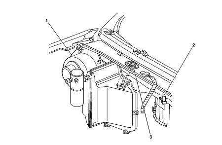

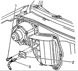

Where is the blower motor resistor on a 2002 chevy blazer?
Saturday, December 15th, 2007 AT 9:54 AM
16 Replies
DENNYP
  • 1,824 POSTS
https://www.2carpros.com/forum/automotive_pictures/102900_595462_1.jpg
https://www.2carpros.com/forum/automotive_pictures/102900_531763_1.jpg
(1) Blower Motor and Connector
(2) Blower Motor Relay
(3) Blower Motor Resistor and Connector

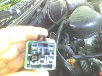

I have had a perpetual problem with the blower on this blazer. This is now the 4th time that I have progressively lost the blower control on this car. Initially the dealer tried to fix it by replacing the blower switch, but this failed in short order. The other 2 times, with two different repair shops, the problem has been determined to be the blower fan resistor. The last blower resistor replacement was about a year ago. It worked beautifully for about 3 months, I started to lose the lower settings, and then eventually it stopped working all together. It seems to me there must be a bigger cause for this same issue to continue to recur. I'm looking for help and suggestion on what may be behind the repeated failure. Also, we're willing to try the repair on our own this time, but need help locating the resistor to replace it (and whatever else you may determine could be causing this)

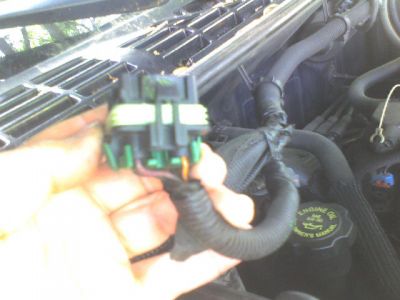

LITAGATOR
I was able to locate the resistor and pull it out and check it. The resistor seems to be just fine. So I went "upstream" to the relay. One of the contacts inside of the relax was fried to a crisp, and had actually melted part of the plastic casing inside. While I can replace the relay, the plug that goes into the relay is another matter. I cannot figure out how to remove and replace the plug end - it appears to go straight into the wiring harness. Thoughts?
Monday, December 28th, 2020 AT 10:58 AM (Merged)
  • 110,194 POSTS
If the connector to the wiring harness has melted down, there should be small clips that when depressed with a small screwdriver allow the wiring to come out.
LEt me know if that is what you mean. I would also check the draw from the motor. It sounds like it is drawing too much power.

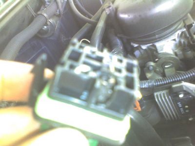

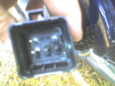

LITAGATOR
Yes, I guess it would be the plug... see pictures attached... it burned through the side of the casing or the plug it shorted so badly... but it is all cleaned up and did work when connected to a new relay. I will need to buy a new plug to put on, however... and will test the fan this evening and let you know.
https://www.2carpros.com/forum/automotive_pictures/520351_connector_side_view_with_burnout_1.jpg
https://www.2carpros.com/forum/automotive_pictures/520351_connector_top_view_1.jpg
https://www.2carpros.com/forum/automotive_pictures/520351_clip_view_with_wire_insertion_1.jpg
https://www.2carpros.com/forum/automotive_pictures/520351_relay_burn_view_1.jpg
Not great quality taken with cell cam -but I think you can see it enough
  • 110,194 POSTS
Actually, the pictures are great. It looks like something is drawing too much power and overheating the connection.
Let me know what you find.

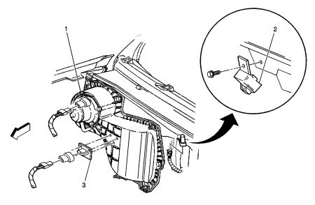

CHUCKB
  • 1998 CHEVROLET BLAZER
Heater problem
1998 Chevy Blazer 6 cyl Four Wheel Drive Automatic 119.00 miles
i can not locate the resistor
Monday, December 28th, 2020 AT 10:59 AM (Merged)
BRIAN 1
  • 1,030 POSTS
https://www.2carpros.com/forum/automotive_pictures/147643_resistor_1.gif
the resistor is #2
