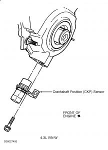

I need to replace a crankshaft position/crank angle sensor, need to know where it is located? Maybe a diagram.
Saturday, April 3rd, 2010 AT 2:24 PM
BMRFIXIT
MECHANIC
19,053 POSTS
Crankshaft Position (CKP) Sensor (4.3L VIN W) On front of engine, near crankshaft pulley
