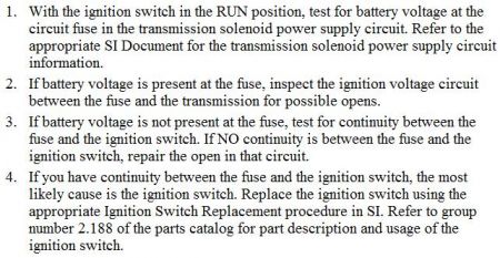

The codes for the 1998 chevy blazer is PO785. We tried to clear the code but the minute we turned the ignition back on it came back on. Same trouble.
Saturday, May 9th, 2009 AT 8:33 PM
ZACKMAN
  • 4,202 POSTS
It is your ignition switch. TSB 01-07-30-002.
https://www.2carpros.com/forum/automotive_pictures/55316_98blazerp0785_1.jpg

We still have the same problem after changing the transmission, throttle position sensor and ignition switch. The same code (p0785) still comes on and the check engine light is still on. We are at a loss please help before we spend more money than needed.

Here is one tip found in Mitchell's website.
Malfunction indicator lamp (MIL) on, trans stuck in 2nd or 3rd gear, instrument cluster inoperative (diagnose & replace ignition switch if necc). See bulletin #01-07-30-002. Techs in field report IGN switch failure is common & may cause multiple symptoms with trans, IPC or other IGN feed circuits. (DTCs) P0740, P0753, P0758, P0785, P1860 may be set.
Most likely cause of this condition may be a loss of power to the transmission on circuit 1020.
To verify, with the ignition switch in the run position, test for battery voltage at the appropriate fuse listed below.
1997 s/t trans 24
1998-2003 s/t (old style) cluster 11
2002-2003 s/t (new style) ignition 0
1997-2000 c/k (old style) trans 20
1999-2003 c/k (new style) ignition 0
1997-2002 g-van trans 20
2003 g, h-van ignition 0
2003 H2 ignition 0
After IGN switch replacement, VTD (theft deterrent) relearn must be performed.
***If you have aftermarket alarm or remote starter, I recommend removing them temporarily.***
I am sending you the complete P0785 diagnostic. Did you happen to check the wiring to the transmission?
