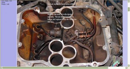

1995 S10 Blazer 4.3L 107K. The Autolite APP25 spark Plugs are fouling out within 5K miles. When I removed the plugs they were all very black, but not wet like oil. So after reading some of the posts it seems that the fuel filter and pressure regualtor should be replaced. I just installed new Distributor Cap and Rotor, Spark plug wires(all were original), and another set of Autolite APP25 plugs. My question is this. Has anyone replaced the pressure regualtor on this car for the same problem? If so did it solve it? How difficult is it to replace the regulator, any tips (gaskets, seals, adj.)? Should I also clean the injectors at the same time? If so any suggestions, I've never cleaned any before? Thank in advance.

Mam, You have to remove the upper plenum-if its the regulator the passenger side would be washed-up. The regulator comes with a kit-you have to drilled out the old one. Don't let nobody tell you -that you have to get the whole CPI unit its only about 40 bucks or so.
It doesn't have an individual injectors-its all confine in 1 unit with plastic tubings.

If its gone it will-never use that brand-below shows how it looks inside
https://www.2carpros.com/forum/automotive_pictures/12900_vortec_1.jpg
Hope this helps

Rasamtaz, I could not make out the small print on the photo. Are you saying that if the FPR is leaking it will look like the photo? Also if the injectors are leaking can I just replace an "o" ring or seal for them? I did pull out the MTV under the "Vortex" log and I belive that my passenger side may be clean like the photo? The dirver side looks like it may be a little wet or oily? Not sure have to pull upper plenum.

Yup it will look like the photo, you can see the injector on the driver side. When you pull the upper plenum you'll see what am talking about-pax or driver don't matter.
To prove that's something wrong with it-when you open it up turn the key On to check for leakage.
