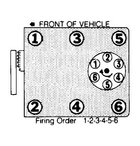

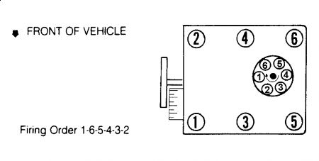

I Think I mix the spark plug cables can U help me please?
motor is 4.3
sorry.

What do u have for engine size ?

Motor size is 4.3

2nd one is the 4.3L
let me know if u need more
good luck
