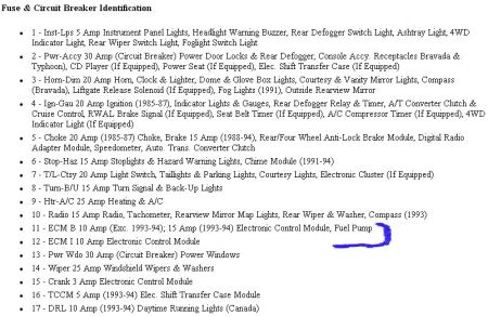

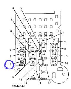

I am told the fuel pump fuse is under the hood but cannot find it.
Where is the fuse box located. I am a 70 yr. Old lady.
not too sharp as u can tell Thanks though, at least I know the number and amps.

Sneaky ol' engineers....
