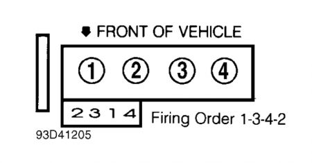

I need the firing order for my car

Firing order for a 2.2.
