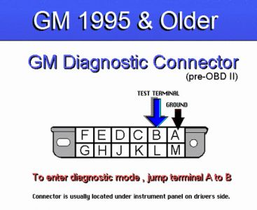

Sir-get the computer scanned for OBD1code/s . The computer has identified a problem with the engine management system-I've been in this business too long and never ran into this problem the type of oil/additive that will pop the CEL, However its very interesting that it works for you at times.
https://www.2carpros.com/forum/automotive_pictures/12900_GM_ALCL_21.jpg
