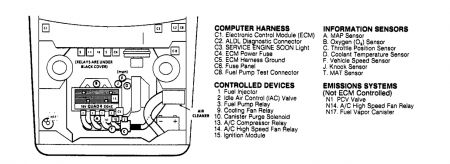

Latest update. When I disconnect the battery wait a few min the reconnect the car will start and run fine for a few min. Then it will go to acting up again and the service engine light will begin flickering on and off then wind up staying on. But there are no codes stored. Is this going to be a bad pcm or a bad wire somewhere. All wiring looks good that I have seen. Is there a relay involved with the pcm on this car. There are 5 relays on the firewall. I know one is for the fan, one is for the fuel pump, so what are the rest for?

How many relays you have, may depend on which beretta you have? You may be able to hit control + on your key-pad to enlarge the picture?
https://www.2carpros.com/forum/automotive_pictures/170934_91_beretta_1.jpg
