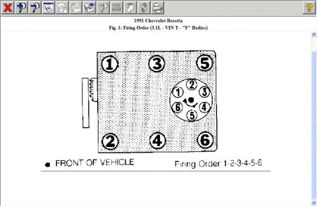

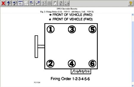

I HAVE A 3.1 ENGINE, IN WHAT FIRING ORDER ARE THE SPARK PLUG WIRES PUT ON BY NUMERICAL NUMBERS?
Thursday, August 7th, 2008 AT 12:28 AM
MECHANIC
75,992 POSTS
Pick your own 3.1L
HTH-Good Luck
