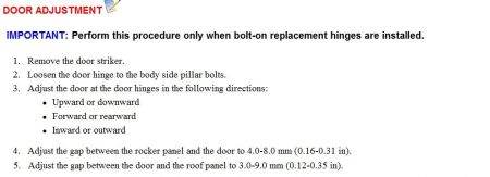

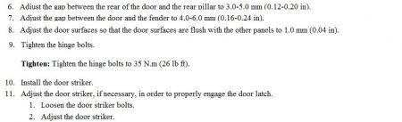

How to adjust rear door as it is rubbing against front door and has damaged trim
Wednesday, August 18th, 2010 AT 2:52 AM
BLUELIGHTNIN6
MECHANIC
16,542 POSTS
Wednesday, August 18th, 2010 AT 6:35 PM
