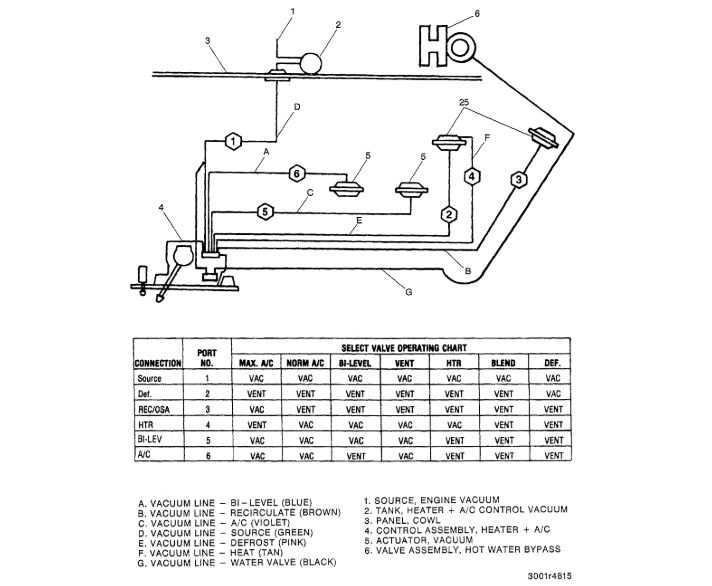

I am in need of a vacuum line diagram if at all possible I have some lines I can't find where they hook up.
Sunday, July 25th, 2010 AT 9:37 PM
4 Replies
SATURNTECH9
MECHANIC
30,869 POSTS
There you go.

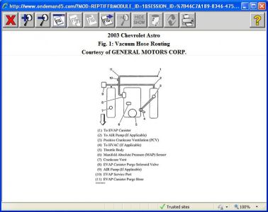

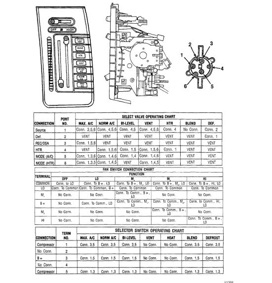

Vents in cabin cannot be regulated. No cold air comes out except to floor.
Friday, December 25th, 2020 AT 9:42 AM (Merged)
MECHANIC
52,796 POSTS
Good afternoon.
If you have floor vent, then you have vacuum to the control head.
The vacuum rotary valve behind the dash at the control panel directs vacuum to the different mode doors.
I attached diagrams for you to follow.
