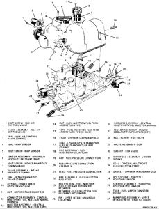

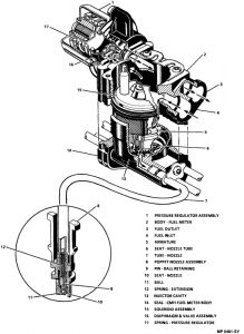

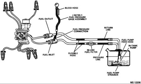

OBXAUTOMEDIC
  • CAR REPAIR CONTRIBUTOR
  • 3,711 POSTS
OK, No it doesn't take any type of Special Tool. There are what looks like plastic clips that have to be squeezed together to unlock them. How hard they may be to get out from there I am not sure. Here is a couple diagrams............
https://images.2carpros.com/forum/automotive_pictures/188069_fuelinjection95astro_1.jpg
https://images.2carpros.com/forum/automotive_pictures/188069_fuelinjection95astrocloseup_1.jpg
