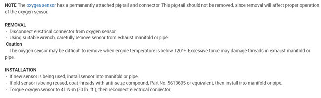

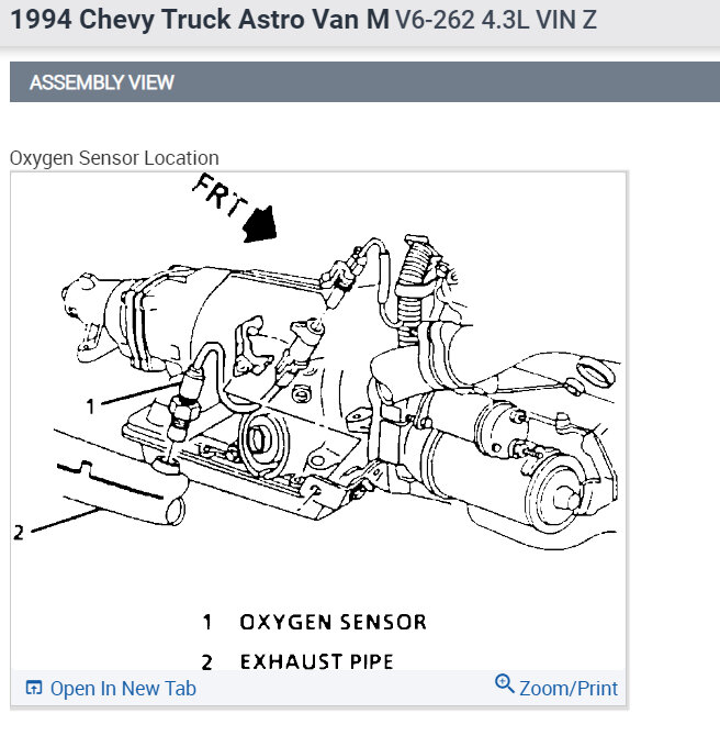

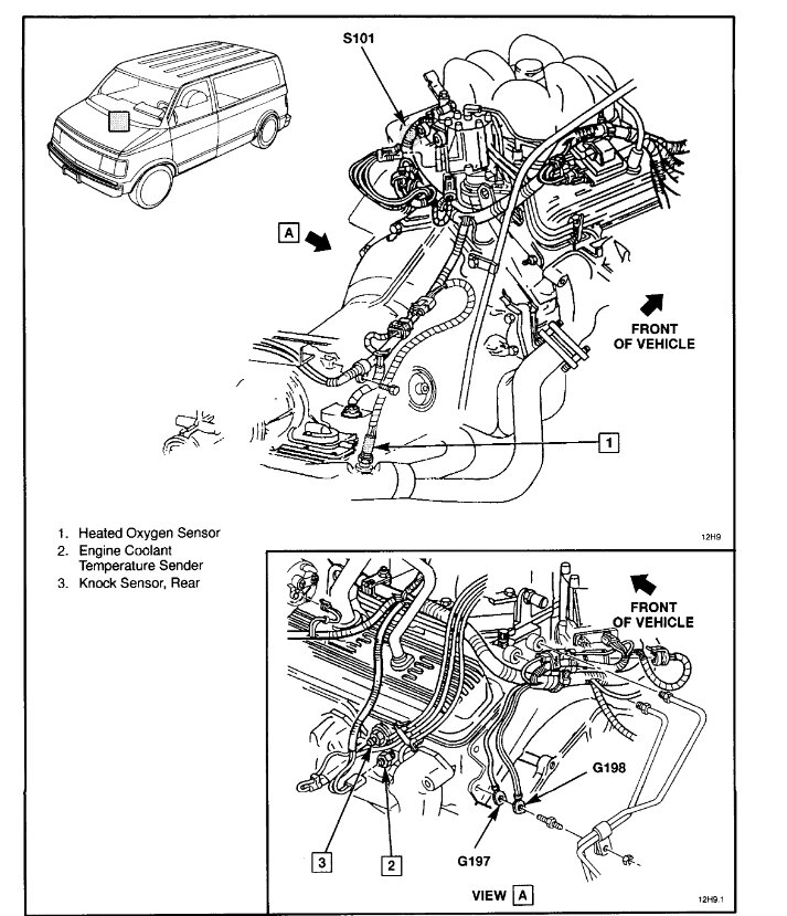

Running rich, horrible mpg, lack of engine power, fouling out plugs on the right side, black smoke bad exhaust smell. where are the 2 O2 sensors located and how to test them and/or replace them?

Sure, here is a guide to help you test the oxygen sensors and the location of the sensor in the images below
https://www.2carpros.com/articles/how-to-test-an-oxygen-sensor-02-sensor
Check out the images (Below). Please let us know how it goes
