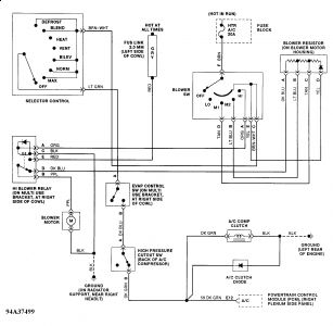

It's on the right side of the radiator, on the support, near the headlight. did you test the relay as outlined?
Here's the wiring diagram if the purple wire has power in all positions, but the fan only works in hi, then either the relay, ground, or blower is defective, run a fused jumper from Battery to the blower motor and one to ground, does it work?
https://www.2carpros.com/forum/automotive_pictures/62217_Graphic_18.jpg
