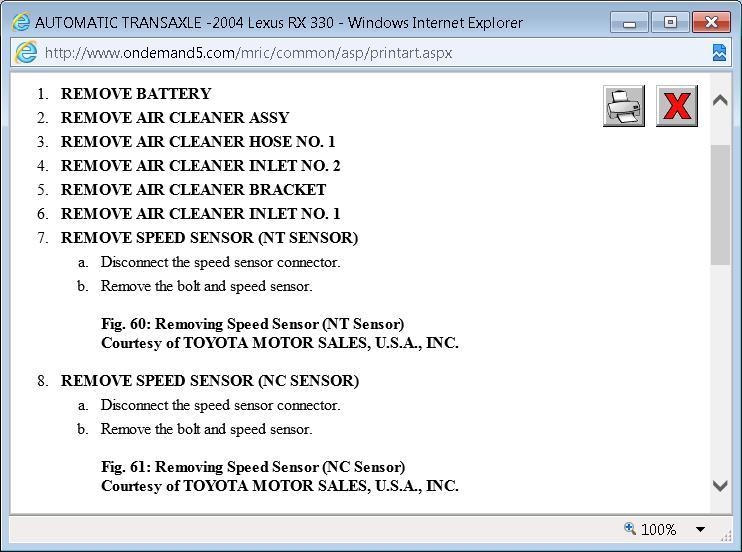

The Check Engine warning light comes on frequently with the error code P0500, Speed Sensor "A".
I would like to repair this fault, if possible. Could you describe the process for replacing a speed sensor?

Let me look that up for you.
Monday, January 13th, 2014 AT 10:45 AM
SATURNTECH9
MECHANIC
30,869 POSTS

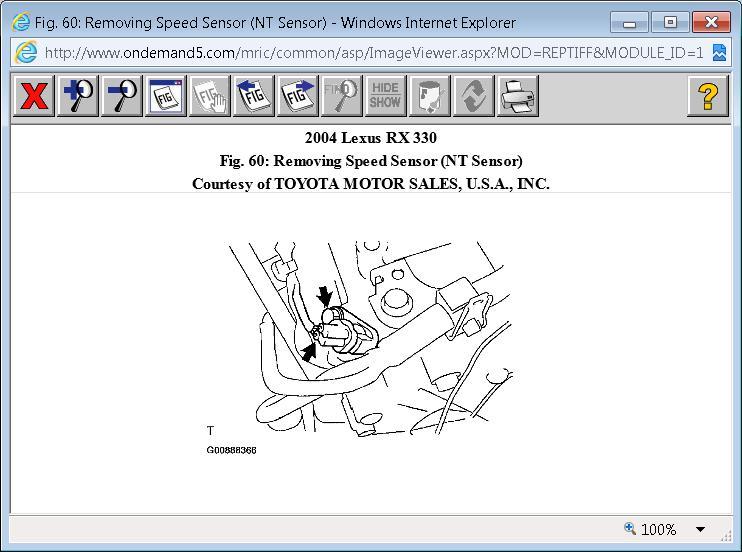

Here you go.
