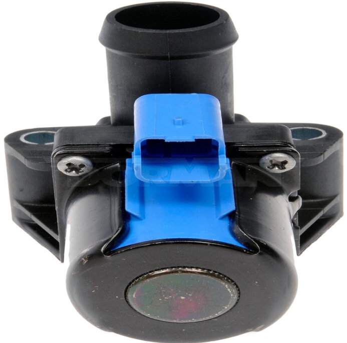

Codes P16E9-00, P0128-00, and P0700-00, check engine light on and blinking drive on the panel?
2016 GMC SIERRA
150,000 MILES • 5.3L • V8 • 4WD • AUTOMATIC
ALVREGON
Is drivable only a few miles and then you can’t drive over 35 MPH. We change the thermostat and the temperature sensor also the cooling antifreeze shows 3 codes P16E9-00, P0128-00, P0700-00.
Thank you for your answers in advance.
May 13, 2025 at 12:22 PM
  • 54,503 POSTS
There might be some confusion on the meaning of this code but from what I found this is the reason:
P16E9-00 - Engine Coolant Bypass Valve Performance
P0128-00 - Coolant Temperature Below Thermostat Regulating Temperature
Also, did you clear the codes after the repair, and did you use OEM parts? Here is the location of the coolant bypass valve and what it looks like.
"Located near the water pump assembly, mounted on or adjacent to the thermostat housing".
So, this code is another problem, please start a new thread for it.
P0700-00 - Transmission Control Module (TCM) Requesting MIL

Thank you, I really appreciate your help and your time. Asking at Autoparts, they said this vehicle doesn’t have an engine coolant bypass valve, just the thermostat. does the same function? but it is already replaced and still has the same problem.

It is strange for sure; the tuck might be considered a 2017. I would call the dealer parts department to help confirm.
