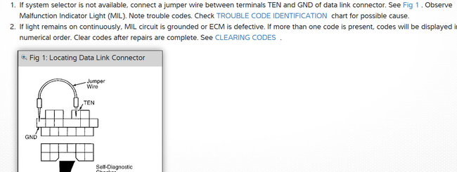

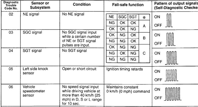

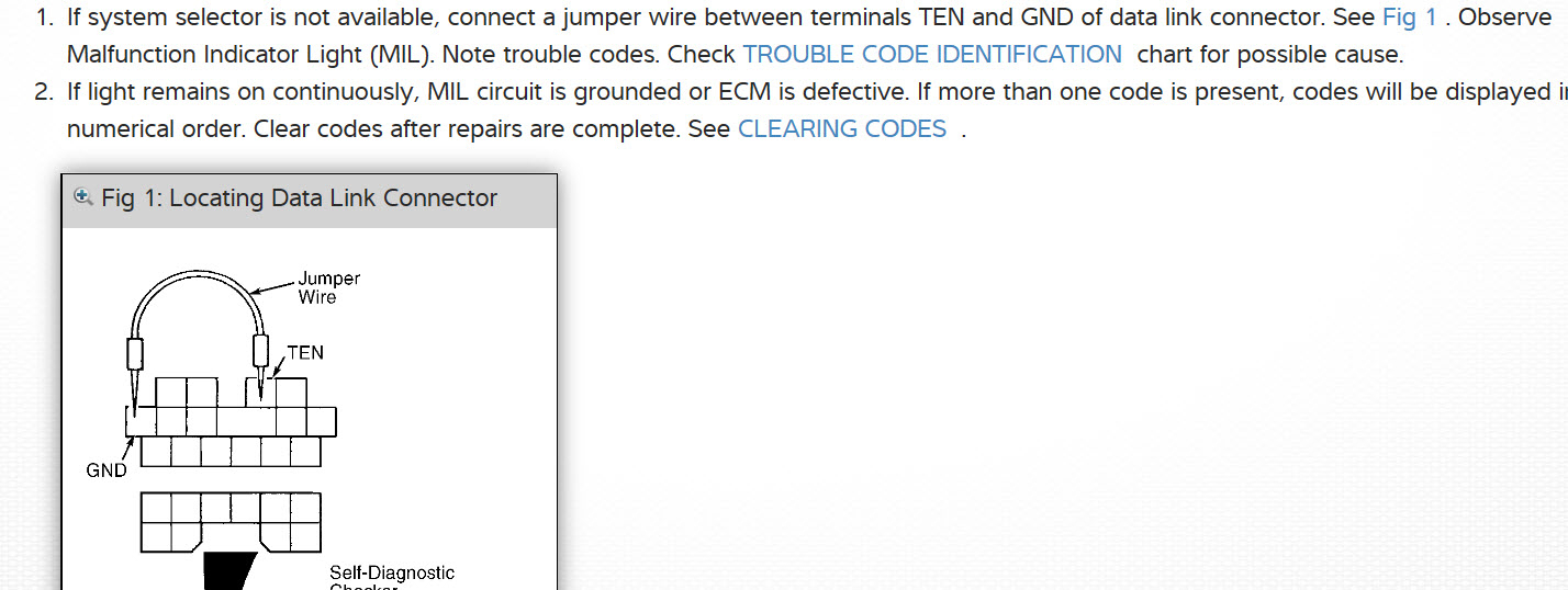

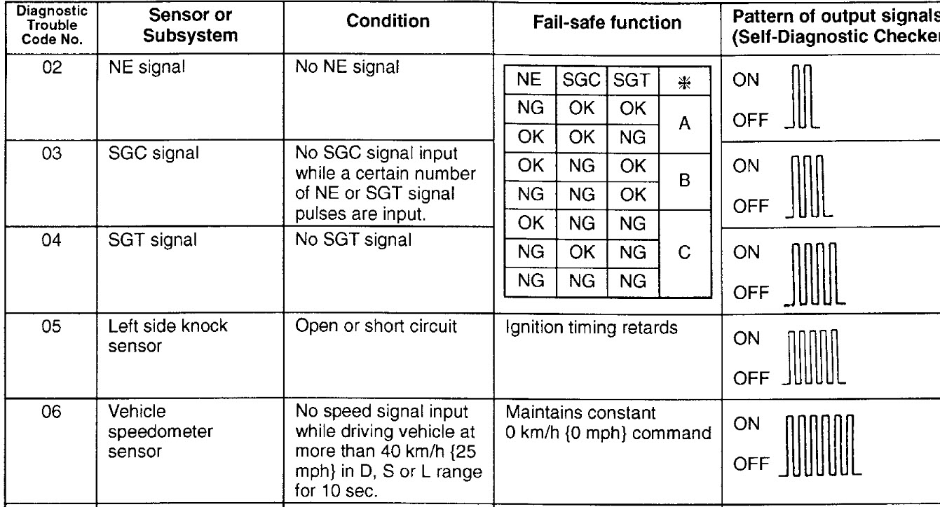

There is too much to copy for codes as they are two numbers of light flashes see example in picture. jumper wire connections sent in picture as well.
https://www.2carpros.com/articles/diagnostic-trouble-codes-for-1995-and-earlier-mazda-cars-obd1
Check out the images (below). Let us know how it goes
