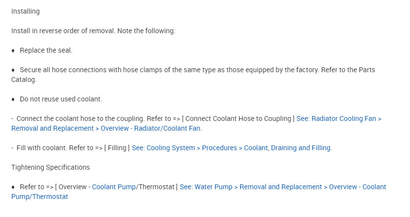

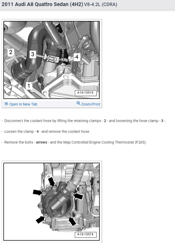

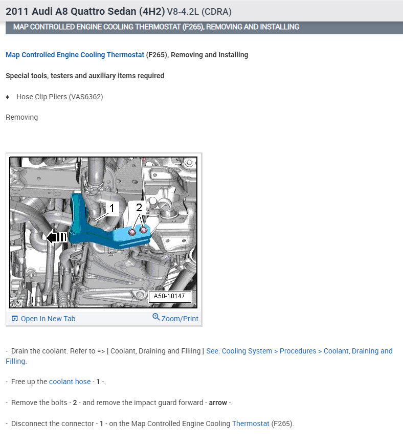

Not sure but I believe thermostat needs to replaced, and I'm not sure how to go about that without significant repair costs.

What code are you getting?
I have attached the thermostat replacement procedure below for your reference.
Let me know of any questions.
