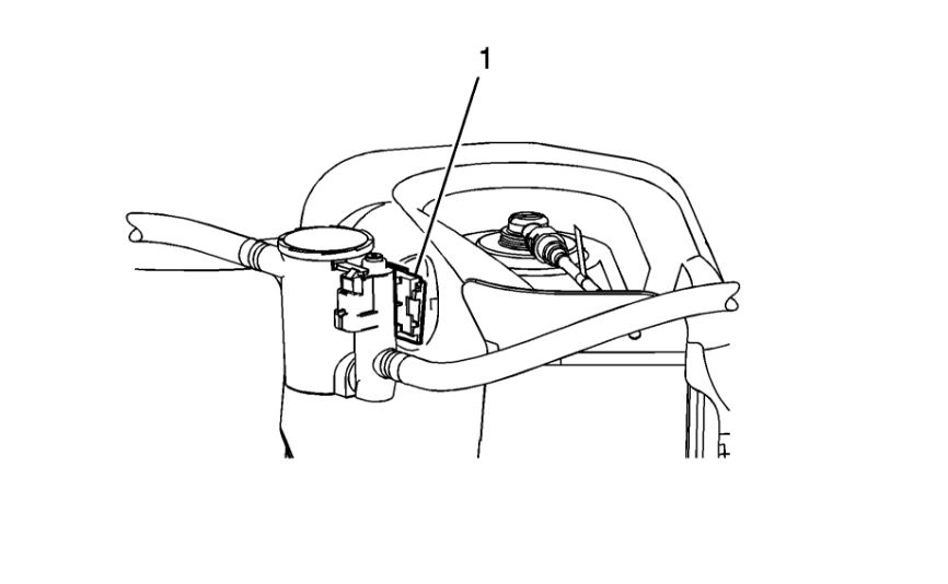

My check engine light has been on for awhile. Not blinking just on. I had the code read and it was the same code as if the gas cap was loose. Changed the gas cap. Did not solve the problem. My truck started spitting and sputtering so I used Seafoam in the vacuum line to clean out the trash, used Lucas fuel treatment, and replaced the MAF sensor. Truck went back to running smooth. Disconnected the battery to reset the check engine light. The next day the light came back on. I read that it may take up to eight times before the computer would recognize the part had been changed. So I reset the light again by disconnecting the battery cables. Light went off yesterday but while driving it this morning the light came back on. Is it possible the computer has not recognized the new part? Or might there be another issue?

Had the code read and it gave the P0449 code.
Tuesday, May 15th, 2018 AT 1:36 PM
Okay, in most cases the vent valve is the failure but needs to be checked to confirm.

Circuit/System Verification
P0443
1. Ignition ON, engine OFF, you should hear a clicking sound when the EVAP canister purge solenoid valve is commanded to 50 percent with a scan tool. The clicking sound should stop when the EVAP canister purge solenoid valve is commanded to 0 percent. The rate at which the valve cycles should increase when the commanded state is increased, and decrease when the commanded state is decreased.
2. Operate the vehicle within the Conditions for Running the DTC to verify the DTC does not reset. You may also operate the vehicle within the conditions that you observed from the Freeze Frame/Failure Records data.
P0449
1. Ignition ON, engine OFF, command the EVAP vent solenoid ON and OFF with a scan tool.
2. Listen for a click when the valve operates. Verify that both the ON, and the OFF states are commanded.
3. Operate the vehicle within the Conditions for Running the DTC. You may also operate the vehicle within the conditions that you observed from the Freeze Frame/Failure Records data.
Circuit/System Testing
1. Ignition OFF, disconnect the harness connector at the EVAP canister purge or vent solenoid valve.
2. Ignition ON, verify that a test lamp illuminates between the voltage supply circuit terminal A and ground.
If the test lamp does not illuminate, test the voltage supply circuit for a short to ground or an open/high resistance. If the circuit tests normal and the voltage supply circuit fuse is open, test or replace the EVAP canister purge solenoid.
3. Connect a test lamp between the voltage supply circuit terminal A and the control circuit terminal B.
4. Command the EVAP canister purge solenoid valve to 50 percent with a scan tool, or the EVAP canister vent solenoid valve ON and OFF. The test lamp should respond to the command.
If the test lamp is always ON, test the control circuit for a short to ground. If the circuit tests normal, replace the ECM.
If the test lamp is always OFF, test the control circuit for a short to voltage or an open/high resistance. If the circuit tests normal, replace the ECM.
5. If all circuits test normal, replace the appropriate solenoid valve.

If it helps any, when I am pumping gas I cannot hold the gas nozzle wide open. It will keep kicking off. I have to wait a few seconds after putting the nozzle in the gas cap and then run it at half speed.
Tuesday, May 15th, 2018 AT 2:12 PM
The valve is a normally open valve. It is commanded closed when the EVAP system is doing its internal test. The valve is not closing causing a large leak.

So we are talking about changing the solenoid?
Tuesday, May 15th, 2018 AT 2:33 PM
No, it is part of the vent valve. You can get it at a parts store.
https://www.rockauto.com/en/catalog/gmc,2008,sierra+1500,5.3l+v8,1441178,exhaust+&+emission,vapor+canister+vent+valve+/+solenoid,16992
Tuesday, May 15th, 2018 AT 2:38 PM
JRAY1987
  • 7 POSTS
Single port or dual port?
Tuesday, May 15th, 2018 AT 3:00 PM
It has two ports. One hose goes to the canister and one to outside air.
There is a two wire connector to the solenoid.
