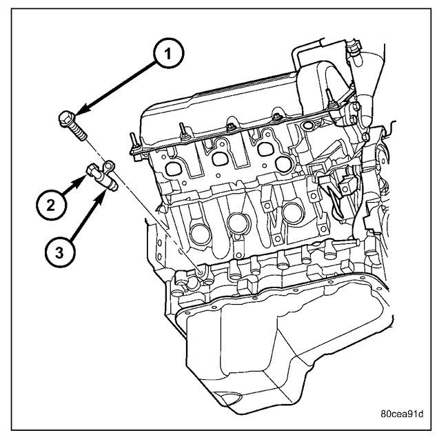

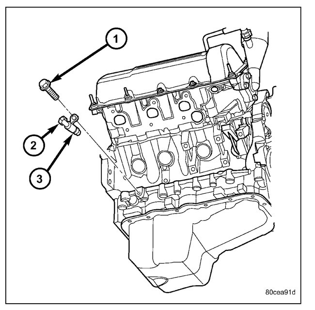

Here are directions specific to your vehicle for replacement. The attached pictures correlate with the directions.
2006 Jeep Truck Liberty 4WD V6-3.7L VIN K
Procedures
Vehicle Powertrain Management Sensors and Switches - Powertrain Management Sensors and Switches - Computers and Control Systems Crankshaft Position Sensor Service and Repair Procedures
PROCEDURES
REMOVAL
pic 1
The Crankshaft Position (CKP) sensor (2) is mounted into the right rear side of the cylinder block. It is positioned and bolted into a machined hole.
1. Raise vehicle.
2. Disconnect sensor electrical connector.
3. Remove sensor mounting bolt (1).
4. Carefully twist sensor from cylinder block.
5. Check condition of sensor O-ring (3).
INSTALLATION
pic 2
1. Clean out machined hole in engine block.
2. Apply a small amount of engine oil to sensor O-ring (3).
3. Install sensor (2) into engine block with a slight rocking and twisting action.
CAUTION: Before tightening sensor mounting bolt, be sure sensor is completely flush to cylinder block. If sensor is not flush, damage to sensor mounting tang may result.
4. Install mounting bolt (1) and tighten to 28 N.m (21 ft. lbs.) torque.
5. Connect electrical connector to sensor.
6. Lower vehicle.

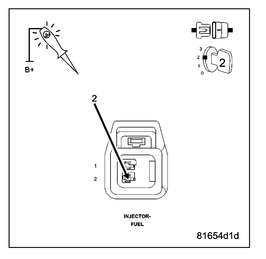

I did have it scanned and it came up as code PO201. A bad fuel injector or wire. Bought both yesterday and my husband will put in today. Hopefully that solves the problem.
Saturday, November 2nd, 2019 AT 12:08 AM
  • 110,192 POSTS
Welcome back:
That's a cylinder 1 injector. If the injector doesn't fix the issue, check for power to the injector. See pic 1 Let me know what you find.

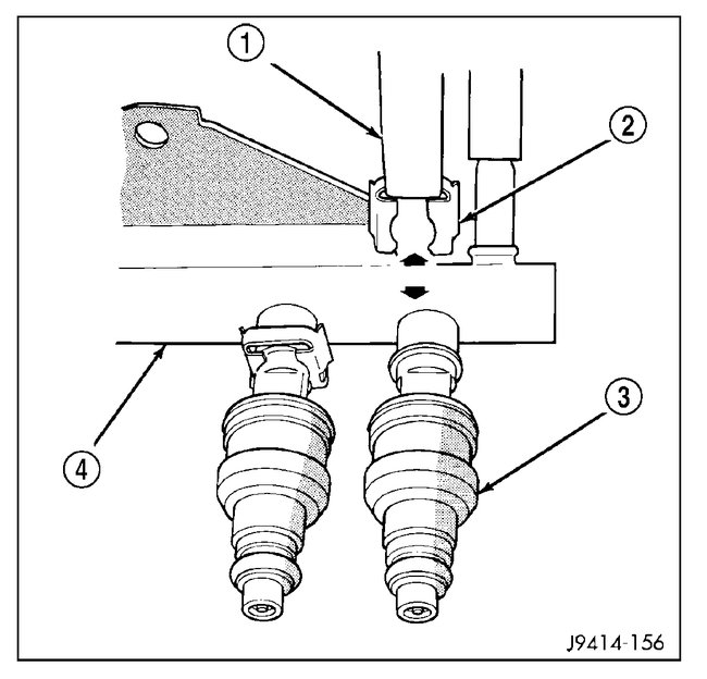

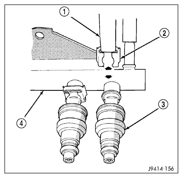

Here are the directions for replacing the injector. Thought I would add them.
________________________
Fuel Injector
Vehicle Powertrain Management Fuel Delivery and Air Induction Fuel Injector Service and Repair Procedures Fuel Injector
FUEL INJECTOR
REMOVAL
pic 2
1. Remove fuel rail.
2. Disconnect clip(s) (2) that retain fuel injector(s) (3) to fuel rail (4).
INSTALLATION
pic 3
1. Install fuel injector(s) (3) into fuel rail assembly (4) and install retaining clip(s) (2).
2. If same injector(s) is being reinstalled, install new O-ring(s). Two different O-rings are being used. These can be easily identified by color. Install black O-ring at intake manifold end of injector. Install red/rust colored O-ring at fuel rail end of injector.
3. Apply a small amount of clean engine oil to each injector O-ring. This will aid in installation.
4. Install fuel rail.
5. Start engine and check for fuel leaks.
________________________________________
Make sure to replace the o-rings on the injector as well. I always lubricate them with a small amount of Vaseline before I install them. It helps prevent damage to the o-ring.
