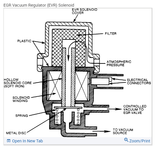

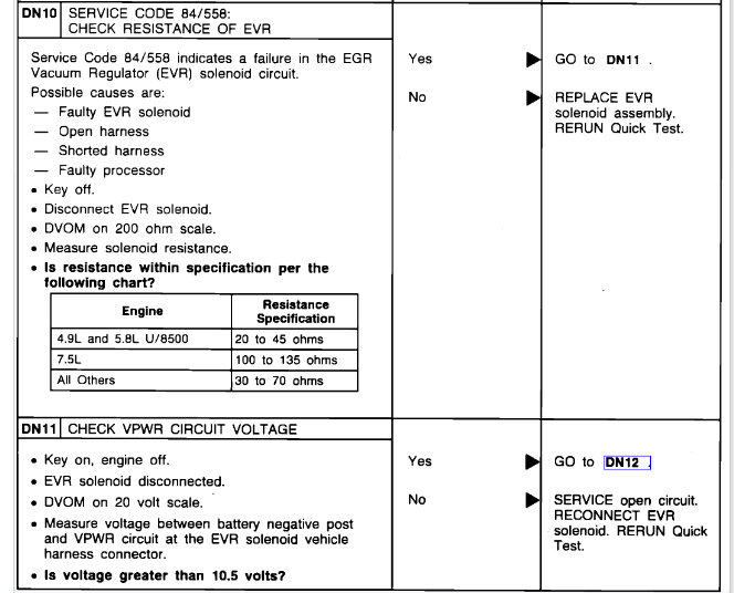

The 558 is where we need to focus. The EGR vacuum regulator (EVR) circuit is failing. This could be a wiring issue, a faulty regulator, or the controller. The EGR Vacuum Regulator (EVR) is a single-unit electromagnetic device with two vacuum ports. The EVR allows the EEC Module to modulate the EGR Valve's opening to any degree, by providing the circuit's ground, internally.
The upper port (see pic 3) is connected to the vacuum chamber of the EGR Valve. The lower port is connected to manifold vacuum or ported vacuum,

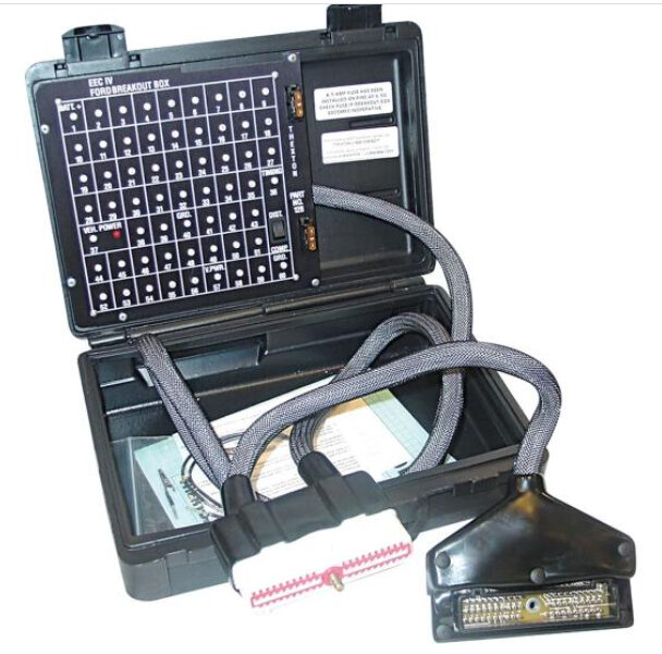

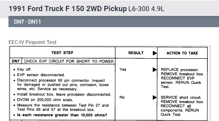

I attached the start of the diagnostics. However, they are indicating the use of a breakout box. This is used to diagnose voltage and resistance issues. It prevents damage to connector pins and simply makes it easier to test. However, most people don't have one.
Take a look through the diagnostics. I included the first tests. If we need to continue further into the diagnostics, let me know and I get them for you.

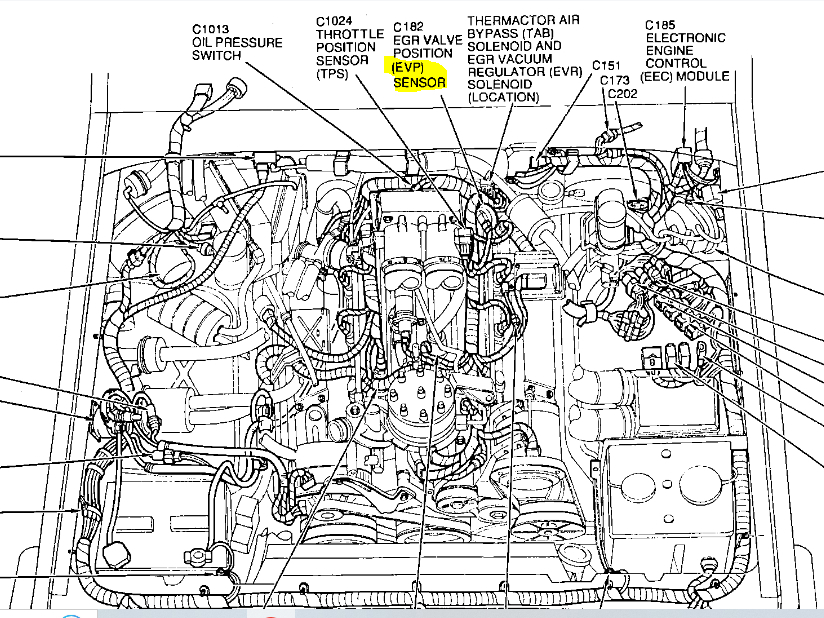

Let me know if this helps or is confusing. Also, let me know if this is something you have already replaced. Keep in mind, because of the year, it could be a connector issue (corrosion, broken pin). Pic 4 below shows location.

Since I retired, I no longer have access to a proper breakout box, so my ability to run all the diagnostics is poor. I've never been a fan of throwing parts at a problem but given the remote area where I live my options are limited. I think I'll give up for a while and keep my eye out for a proper box on the used market.

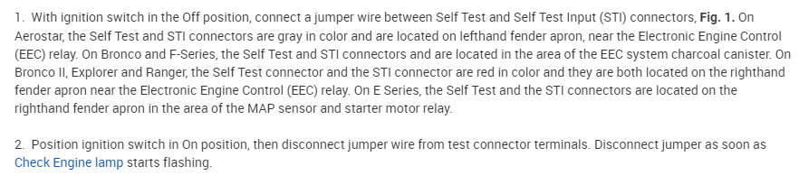

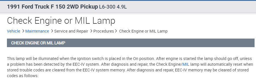

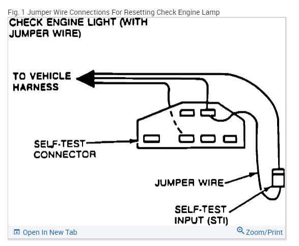

I went through two manuals and still can't find anything indicating a reset button. I was able to find there is a reset module, but when I go to that, it provides only parts, and nothing is listed. However, in the same section, it discusses the reset procedure for the CEL which I attached below. I'm not sure, but this may take care of the light/reset. Take a look through it and let me know if you try it and if it helps. On the other hand, if you already tried this, let me know that as well.
