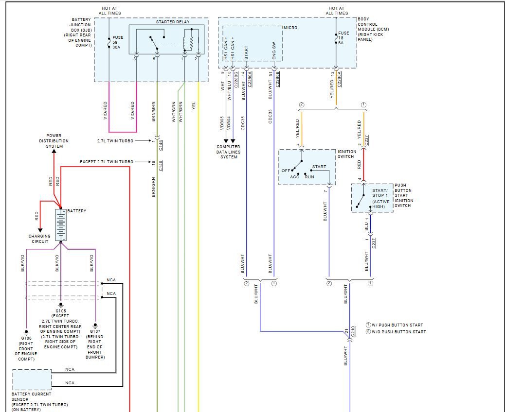

Charging system wiring diagram for starter, alternator, BCM, et cetera?
2017 FORD F-150
67,000 MILES • 2.7L • V6 • TURBO • 2WD • AUTOMATIC
ARDIUS1

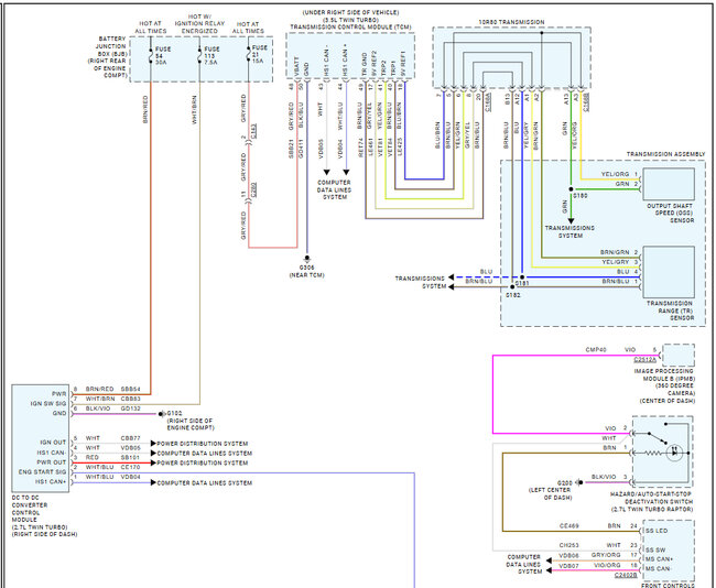

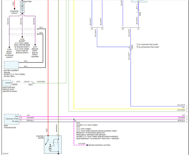

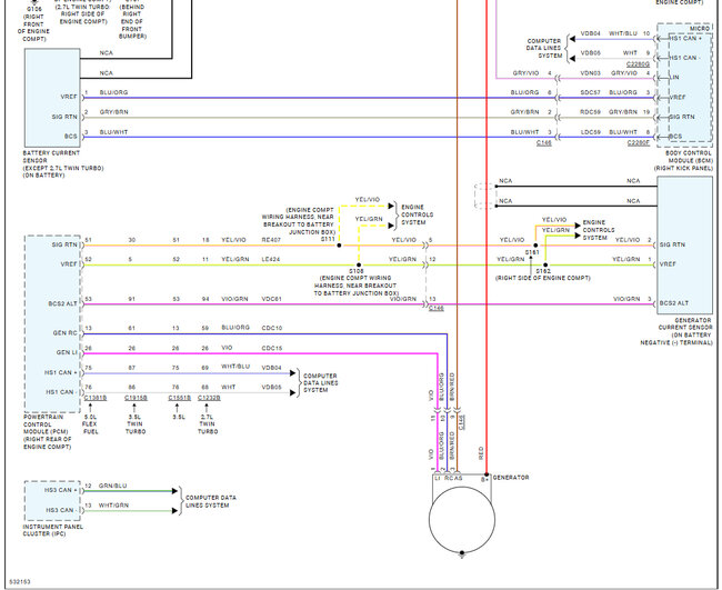

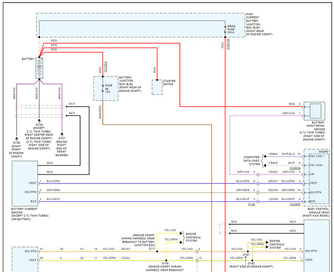

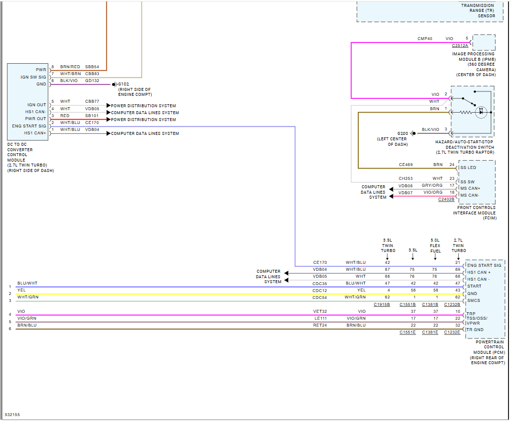

Hello!
I am having difficulty reinstalling the aforementioned components after having to remove harness and clean for oil contamination. I have searched high and low for the corresponding manual and have had no luck finding the 2 or 3 pages needed to determine how this harness is supposed to be put back in. Instead of asking you how it's done, I figured it would be easier on both of us if I just asked for the diagrams and figure it out on my own from there.
Any assistance you can provide would be greatly appreciated.
Thank you kindly!
Aug 19, 2025 at 1:03 PM
  • 54,494 POSTS

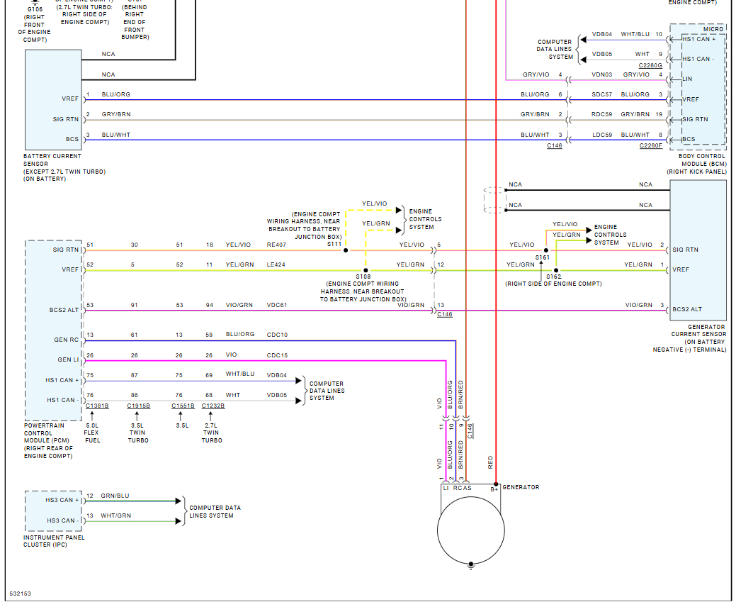

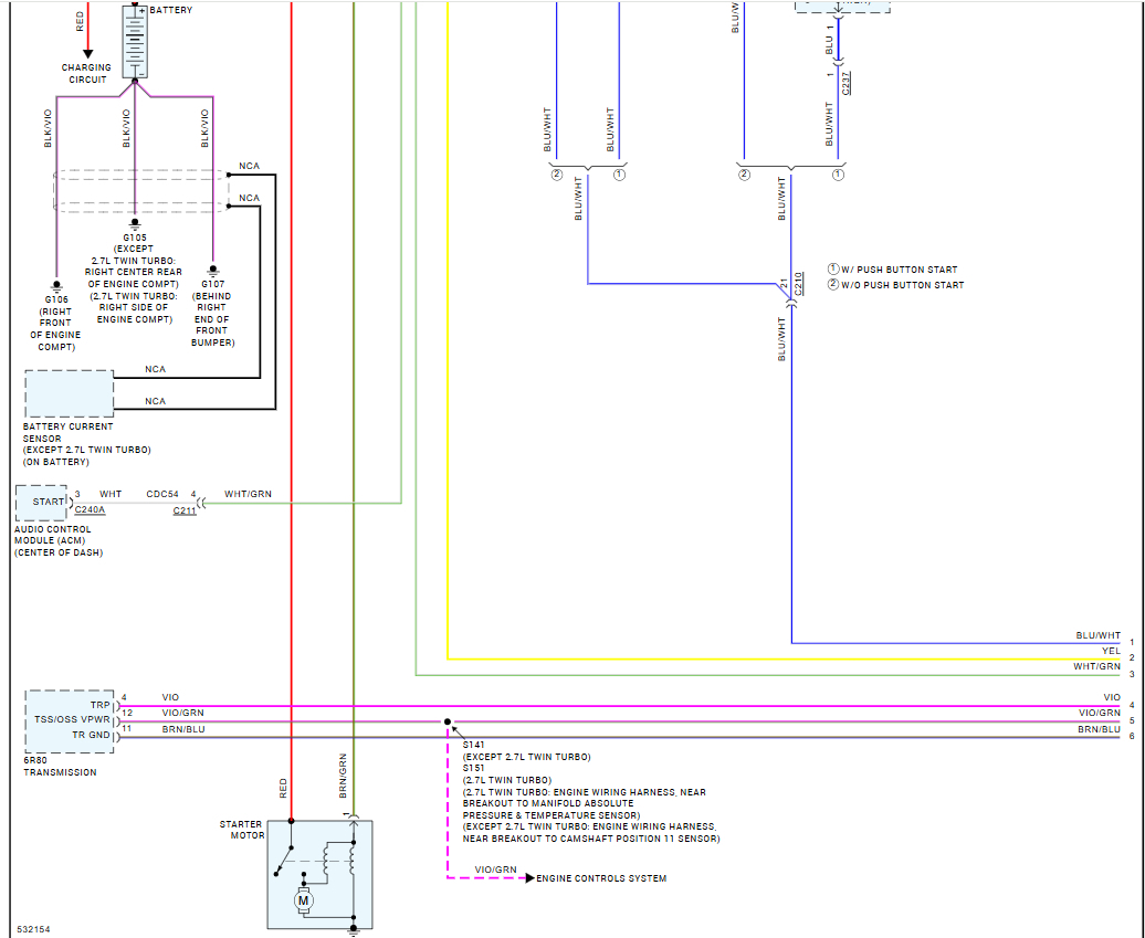

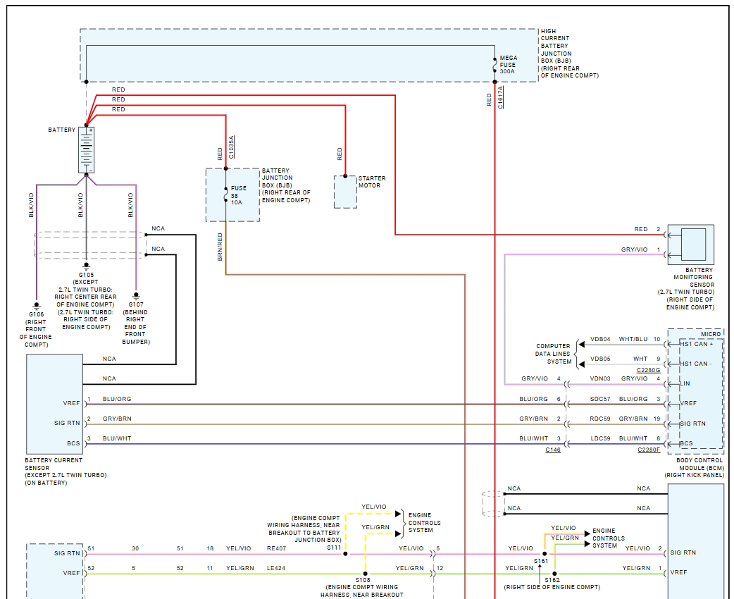

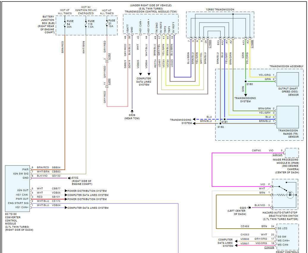

No problem, I can help, but can you ask another question about the BCM wiring. Here are the wiring daigrams for the starting and charging system as requested. Check out the images (below). Let us know if you need anything else.
