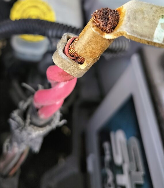

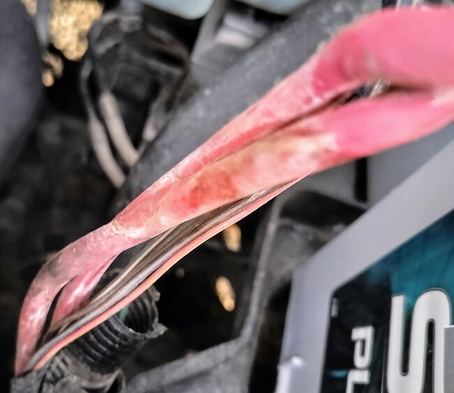

They are too hot to touch. I also used my infrared thermometer, which agreed. The temps rise only when a full load is placed on them. Primarily the audio amp -- I believe. Just got home from work pulled in the driveway and popped the hood; temps were perfect -- no noticeable heat issues.
The cable flash point is very close to what I saw, so I'm taken some precautions:
No tunes
No heater
No defroster
Till I get this ironed out.
Plus, I made two pig tails of 4 AWG, which I'm installing now. I'm working on the premise that the heat difference is pointing to the battery side of the cable(s) integrity issue. This will remove 20cm of OEM cable at the battery. I re-retest afterward.
Stage 2: Get my bypass charge cable in place and disable the original cable at the alternator. Re-test.
Stage 3. Replace the entire starter cable battery to starter with brand new cable. Re-test.
Stage 4. Get the new alternator, belt & tensioner installed. Re- test
Hopefully, I don't have to screw around with the TIPM cable. I don't know how much clearance there is to work/get underneath it. If you have any tips on check points for voltage drop at the TIPM, I would be very grateful.

Houston, we have a problem.
Damn, both cables have to go. I did not sign up for this class!
Do you know what type size connector is at the TIPM?
Sunday, December 14th, 2025 AT 4:45 PM

I looked at the connector views for the TIPM, but they don't show a bolt-on battery cable like I expected. The diagram shows cable # A1 4RD. The "4" indicates it's a 4-gauge red wire. They do show other "B+", (12 volt feed) wires in the connectors underneath, but those are much smaller, as in 12-gauge wires.
I remember hearing or reading stories about some alternators getting hot enough to glow, but I don't if that was exaggeration or what the solution was. Seems to me developing that much current would destroy the diodes.
