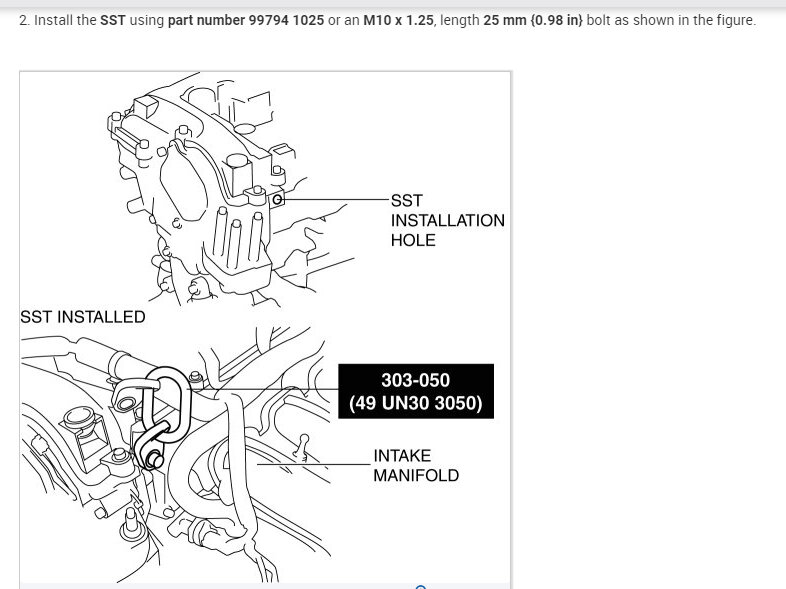

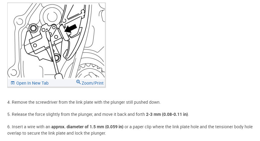

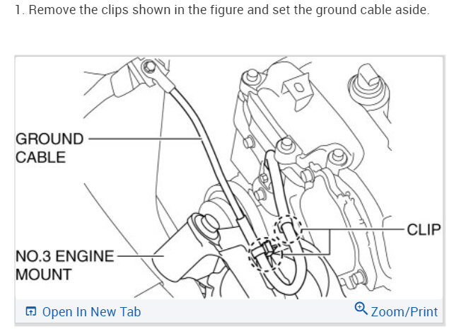

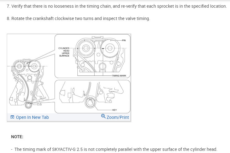

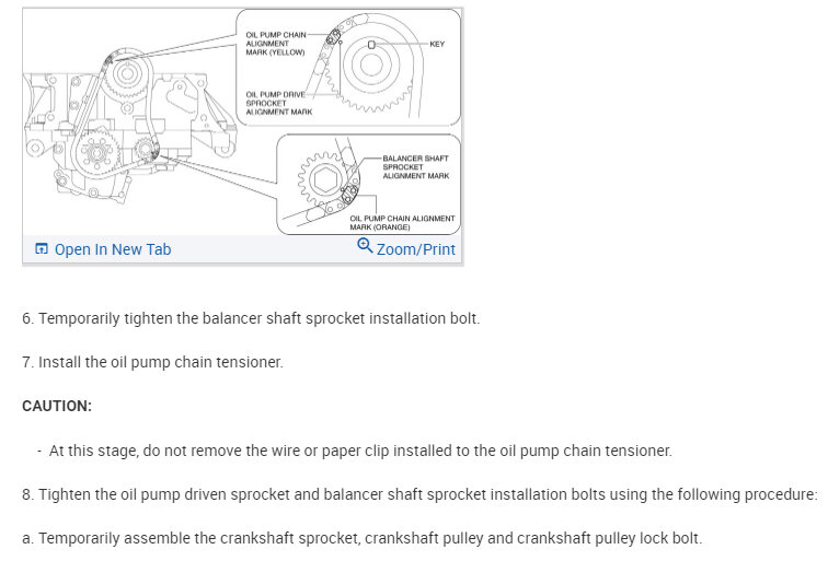

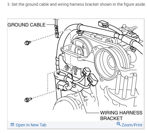

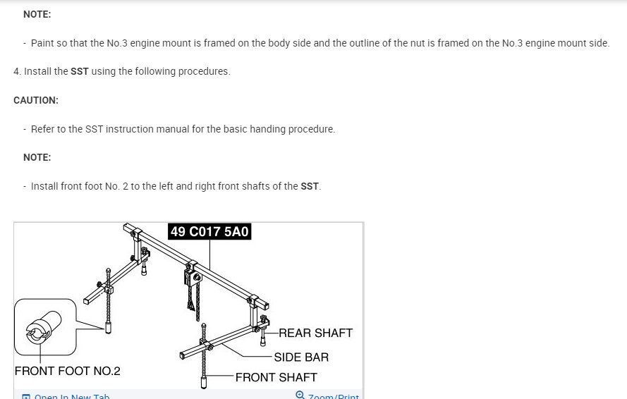

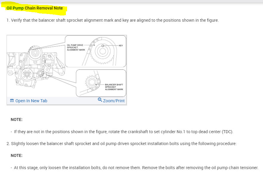

I am pretty handy but never done it on these and want to try it. Can you send some instructions? And any special tools it requires? Car is making a rattle only at load, nothing while idling or driving if you don't push it?
2.5l.
Mar 23, 2023 at 12:15 PM
  • CAR REPAIR CONTRIBUTOR
  • 110,190 POSTS

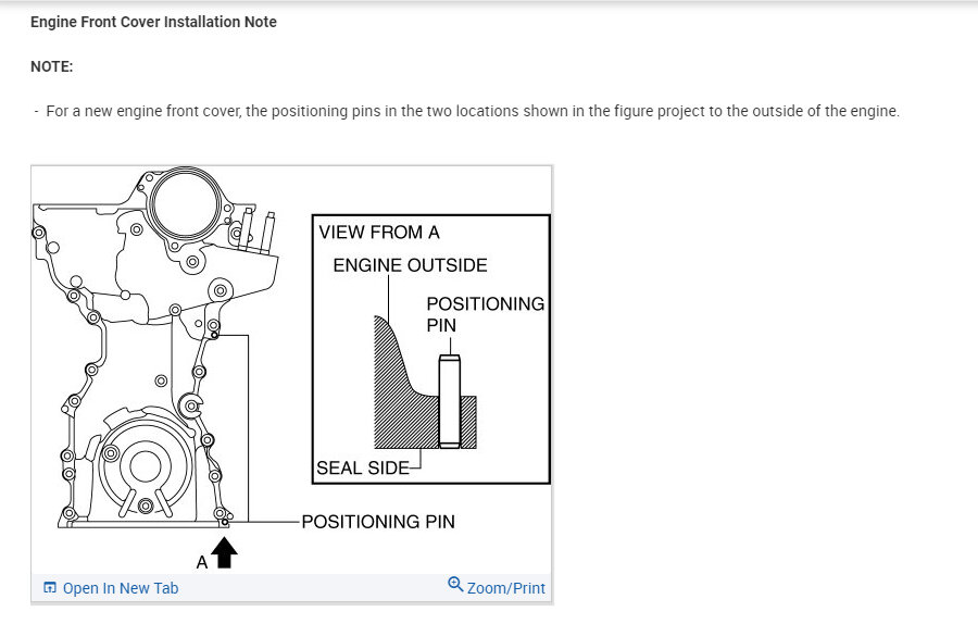

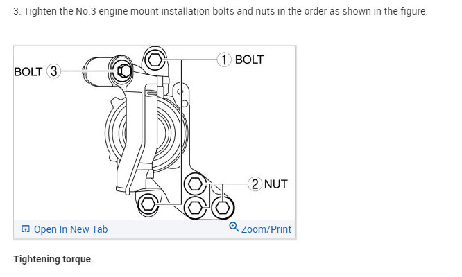

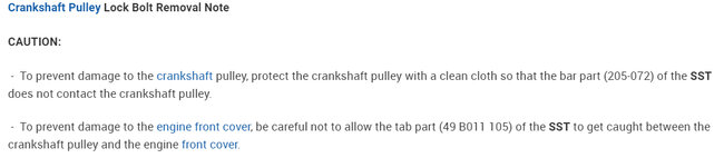

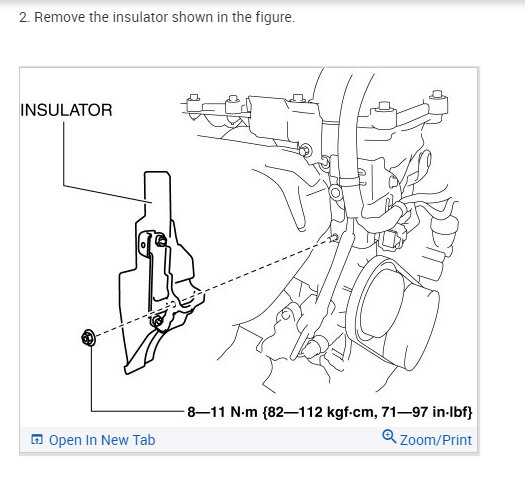

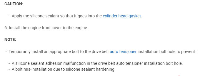

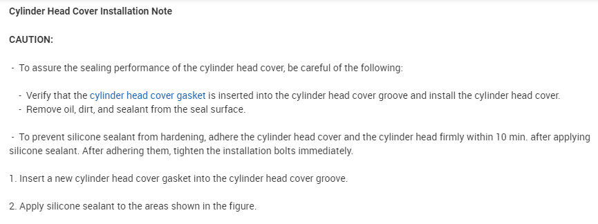

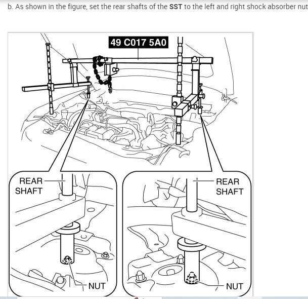

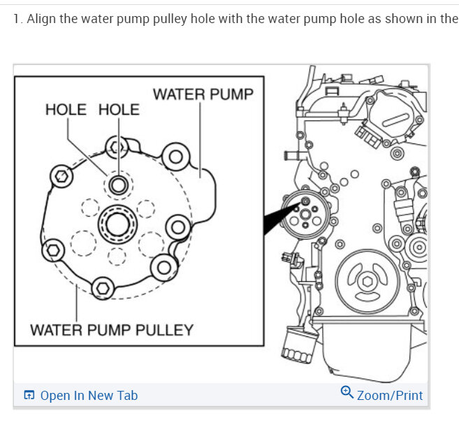

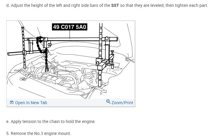

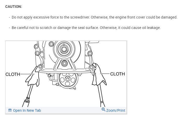

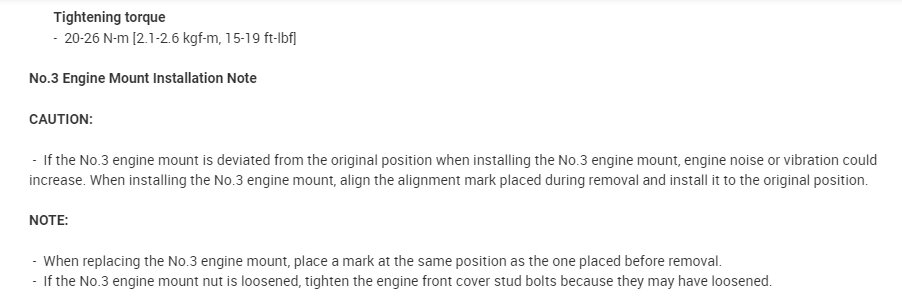

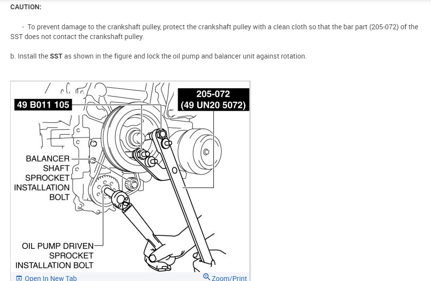

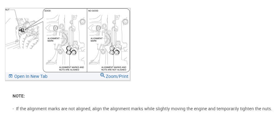

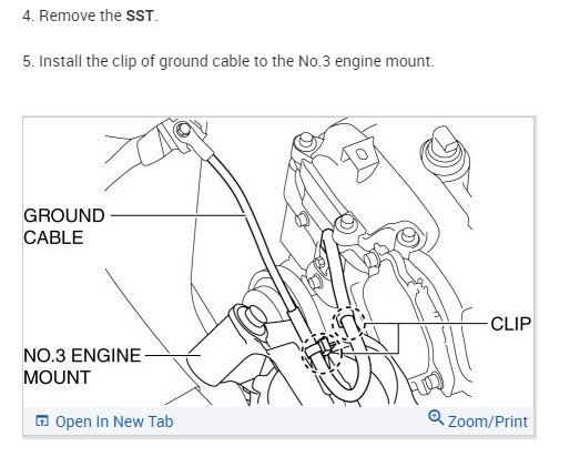

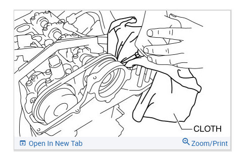

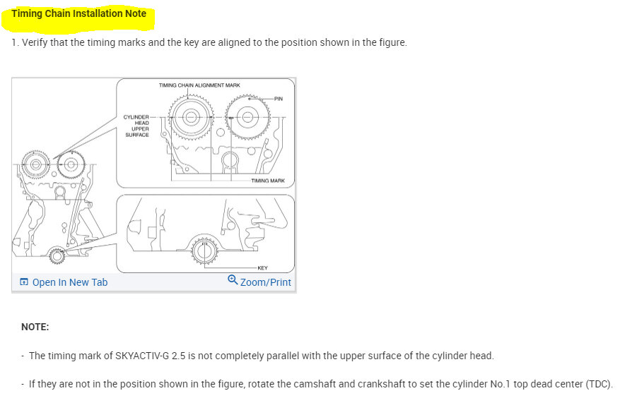

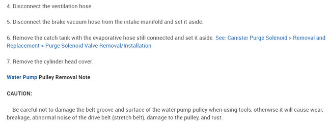

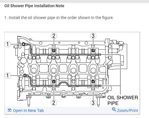

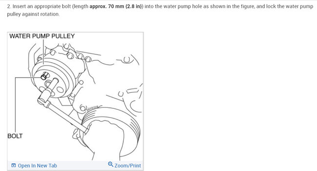

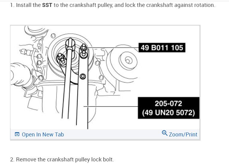

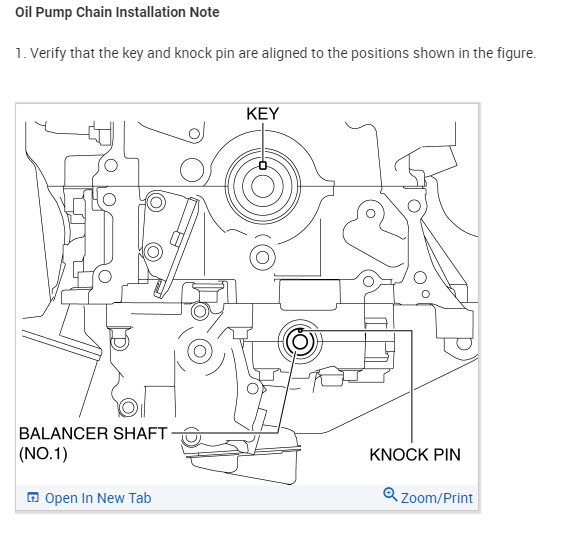

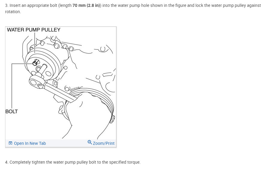

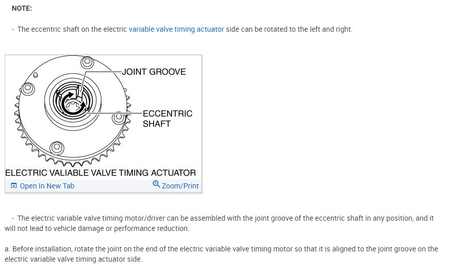

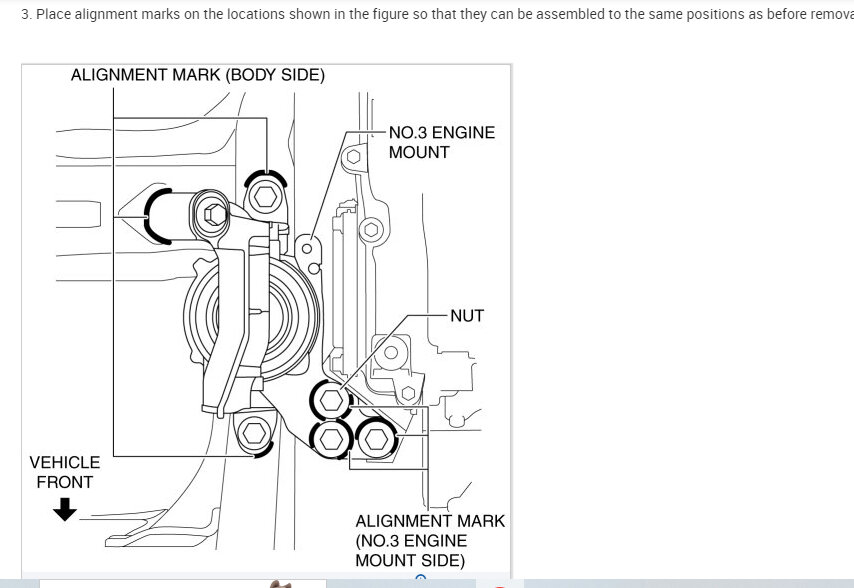

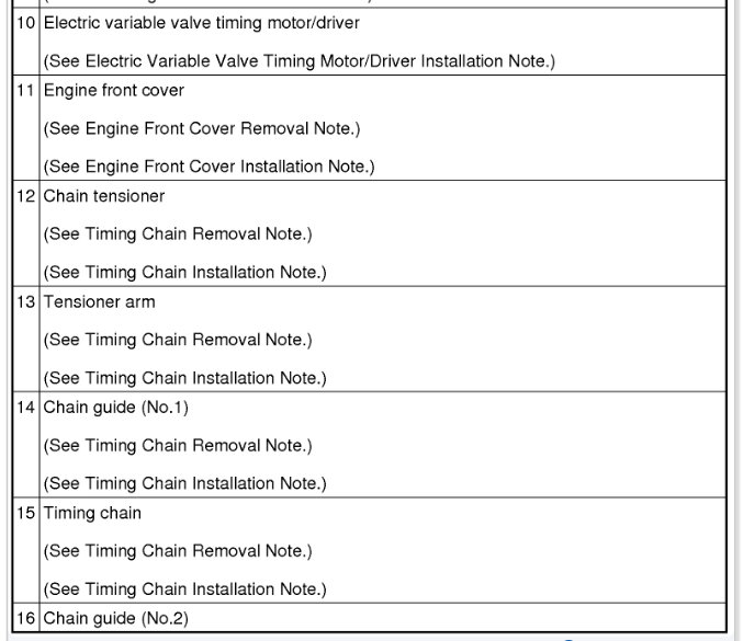

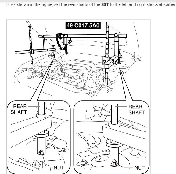

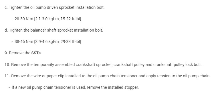

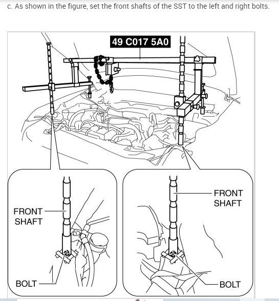

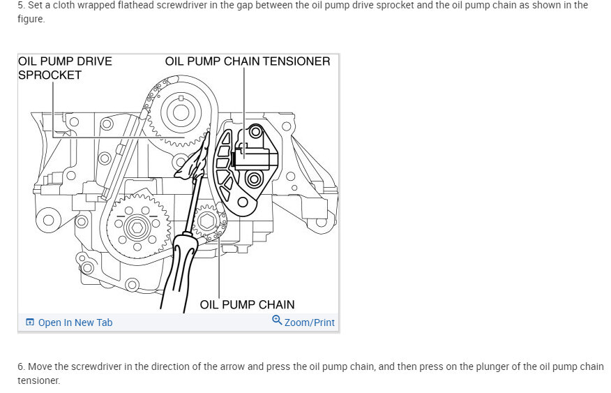

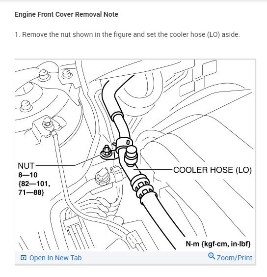

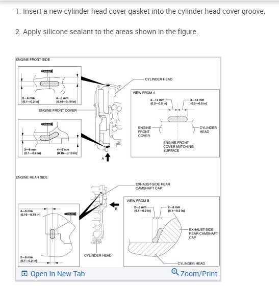

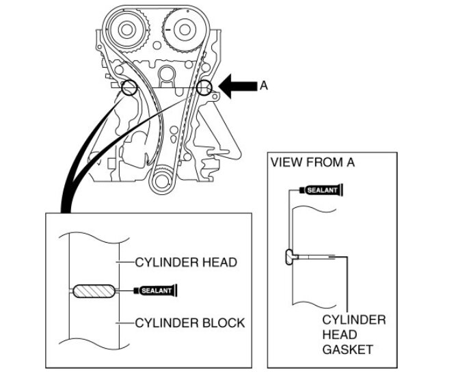

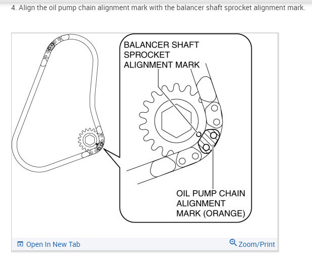

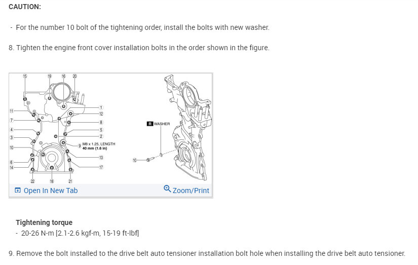

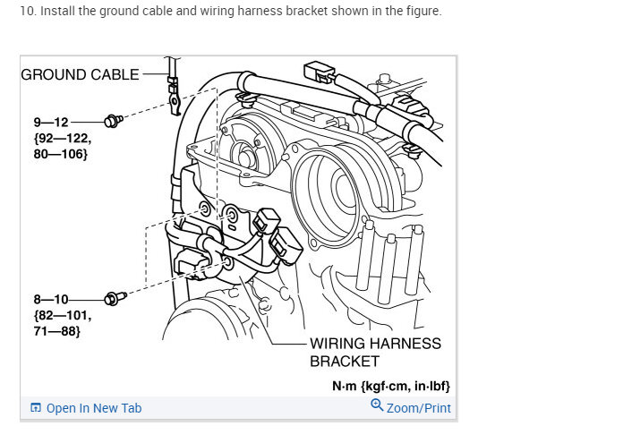

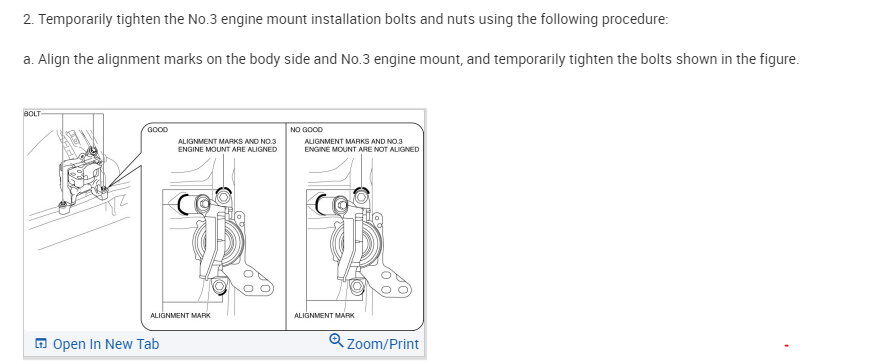

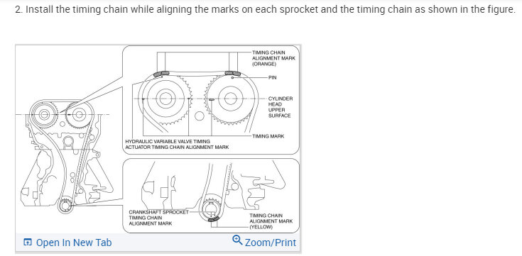

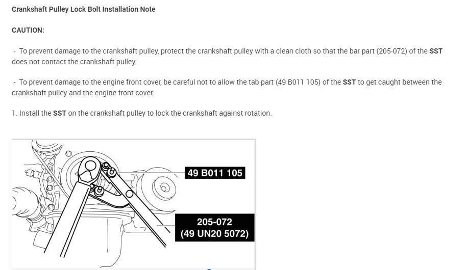

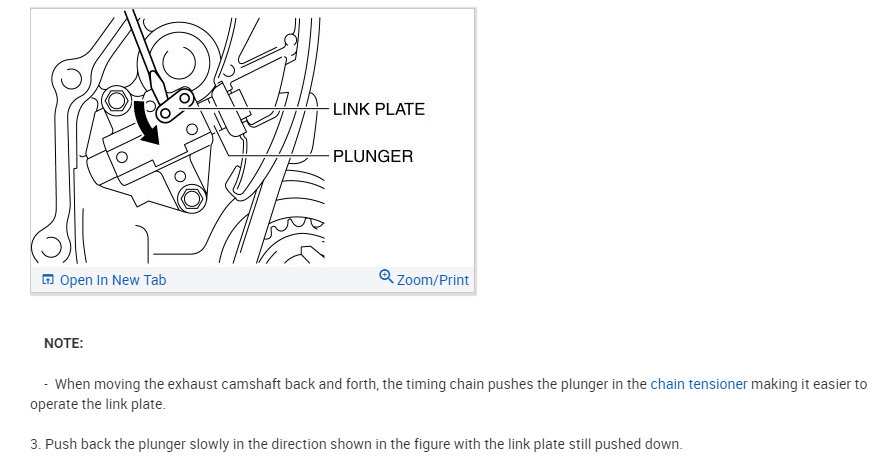

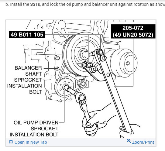

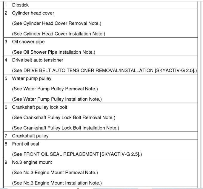

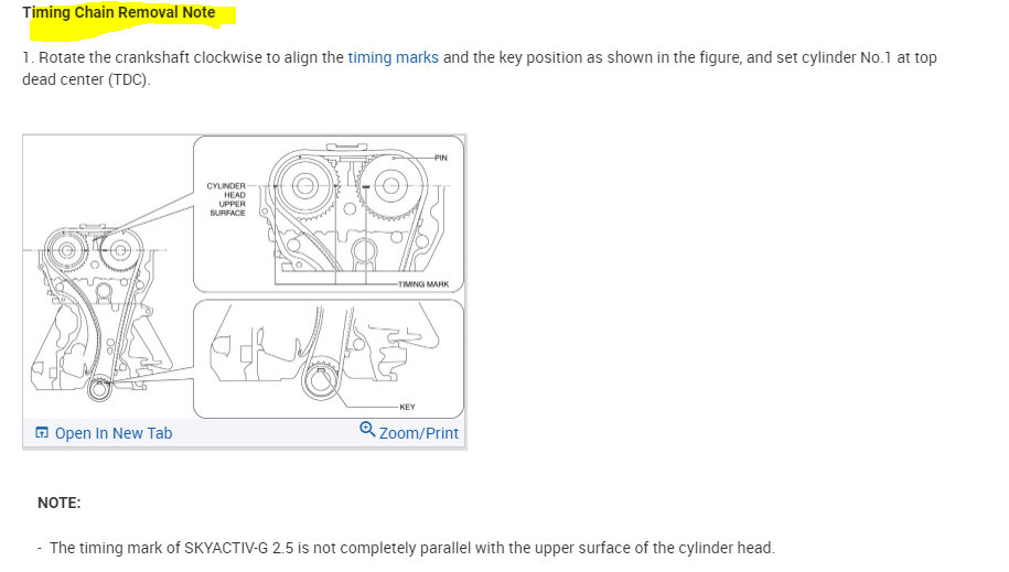

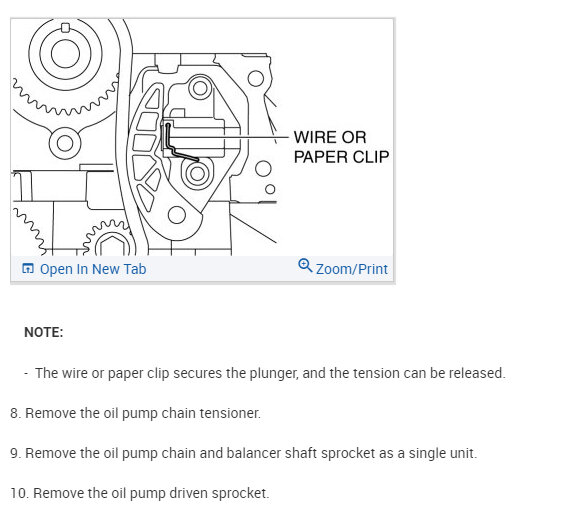

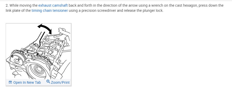

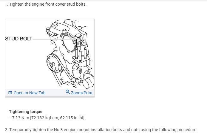

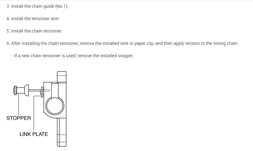

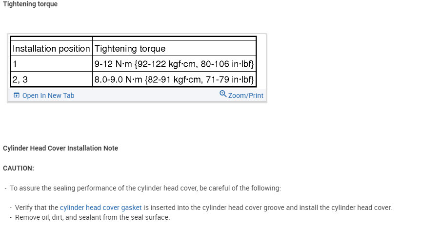

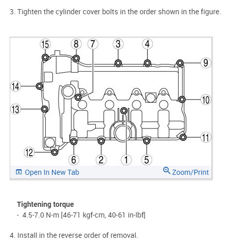

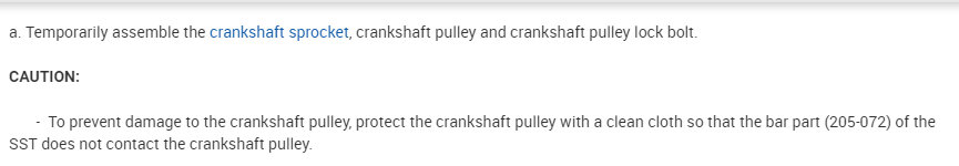

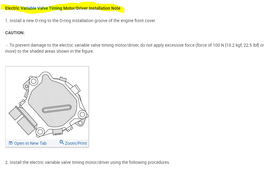

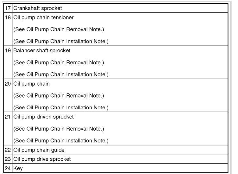

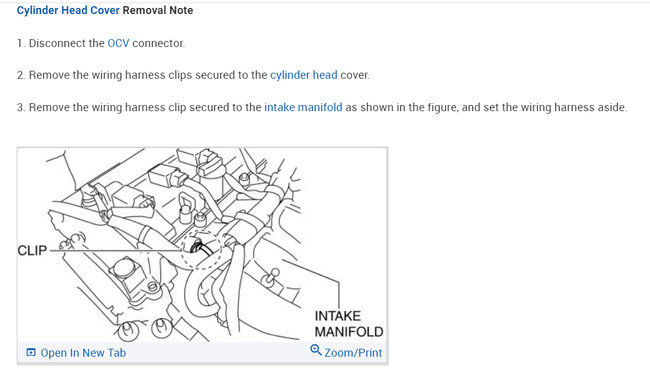

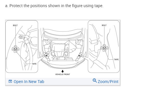

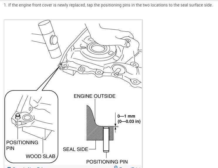

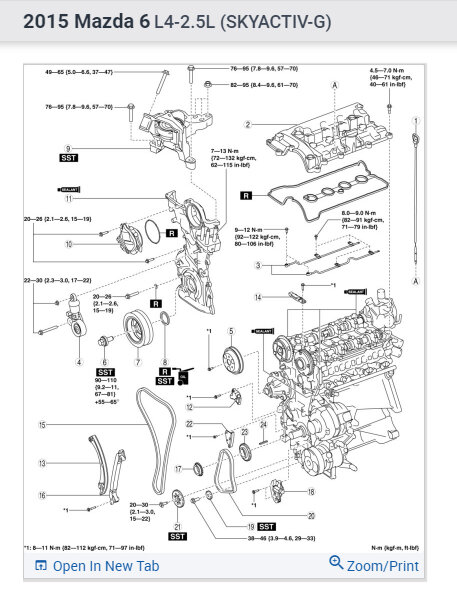

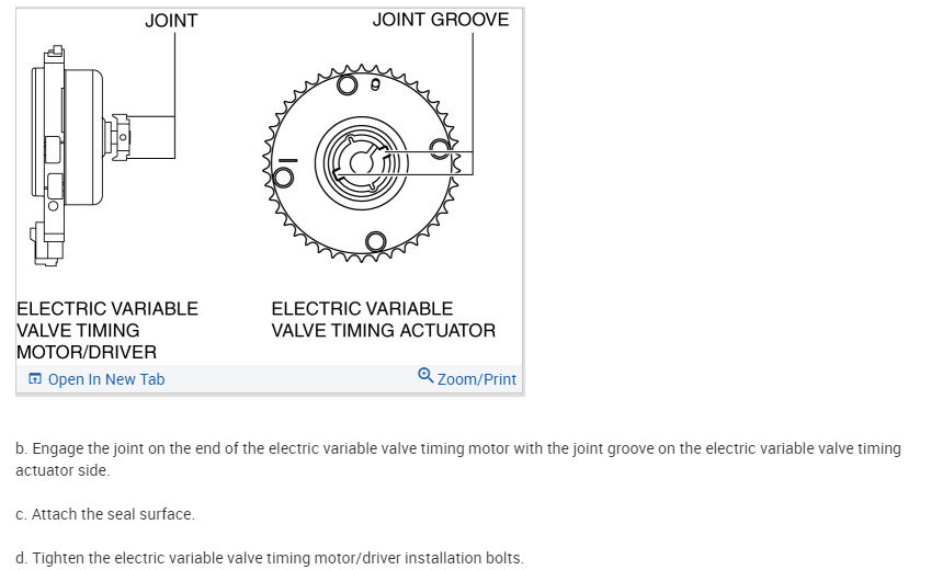

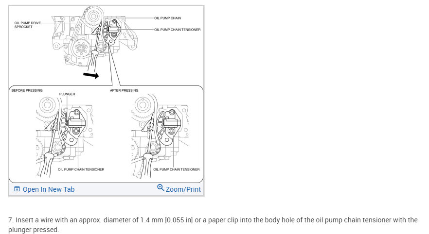

I'm not sure what type you replaced in the past, but these are somewhat extensive. The engine will need support so that you can remove engine mounts. Otherwise, you can't remove the timing chain cover.

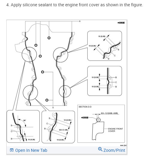

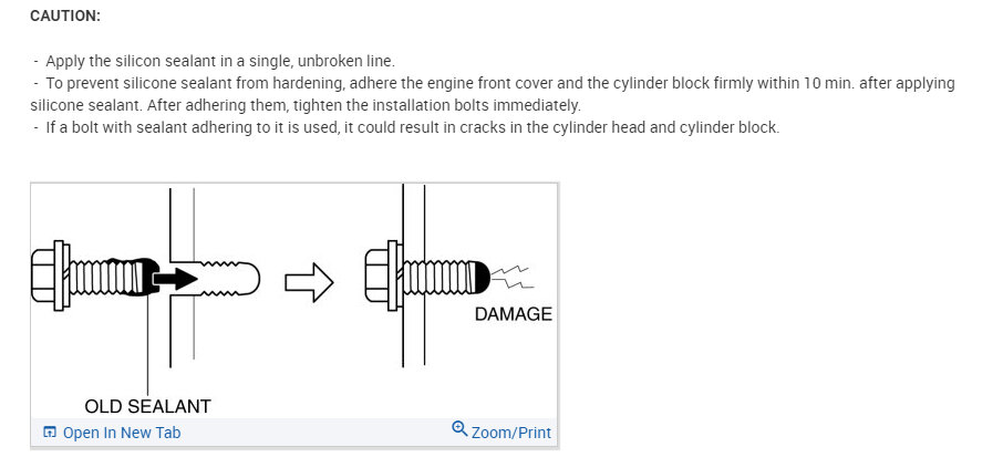

Also, the components are sealed with a gasket maker rather than a traditional gasket. As a result, they can be difficult to remove.

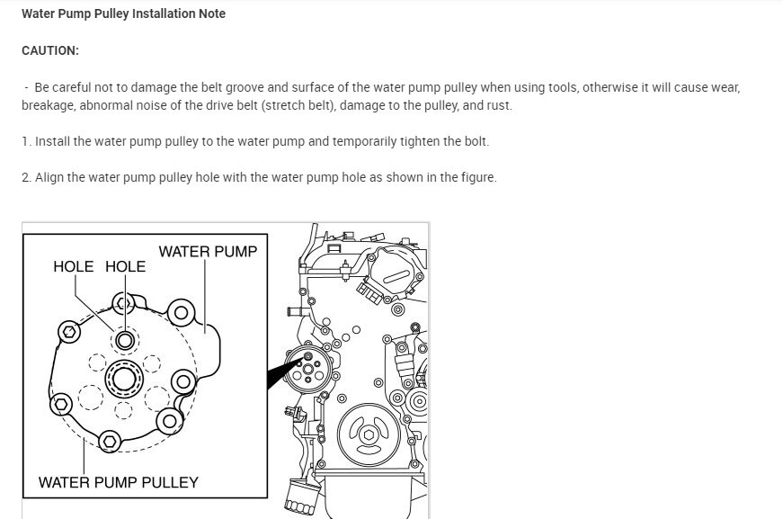

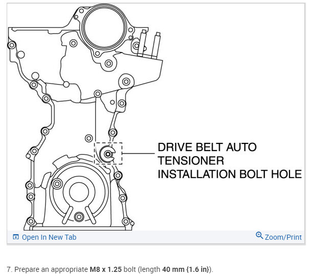

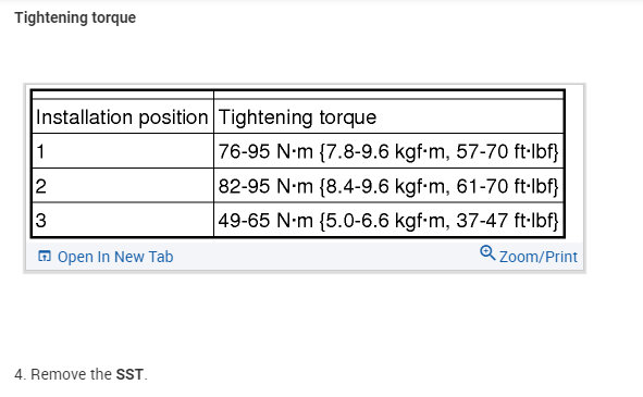

I attached the directions below (which are extensive) for you to review. Take a look through them and let me know if you have questions.

I said the same thing. LOL The problem is you can't access the chain without removing the engine mounts. Nothing is ever easy.
Let me know if you have other questions. Also, note that when you are performing the service, you may find short cuts that can eliminate some of the things indicated above.
