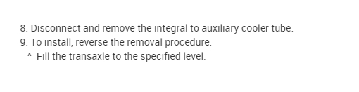

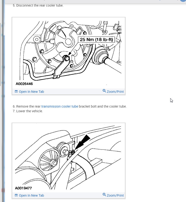

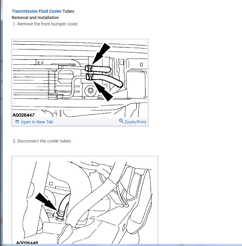

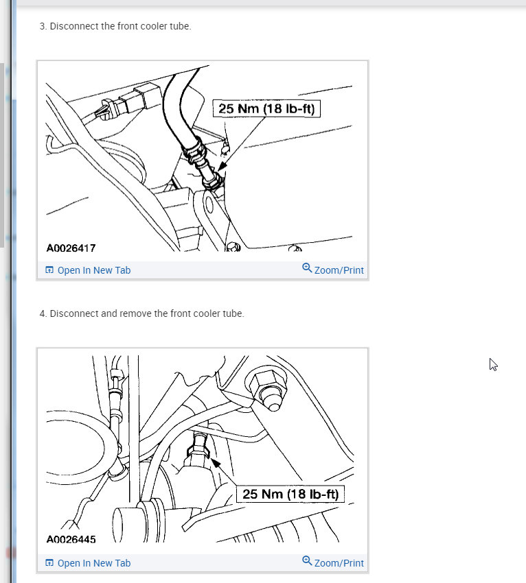

More then likely this is the transmission cooler or a line going to the cooler. Take a look at this process on how to replace it and you will see it is next to the radiator.
The way we need to inspect this is locate the lines and see if they are dripping fluid. If not, then more then likely it is the cooler itself.
Let us know if you have questions on this and we can go from there. Thanks
