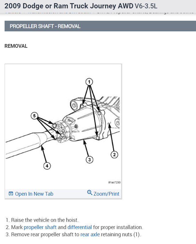

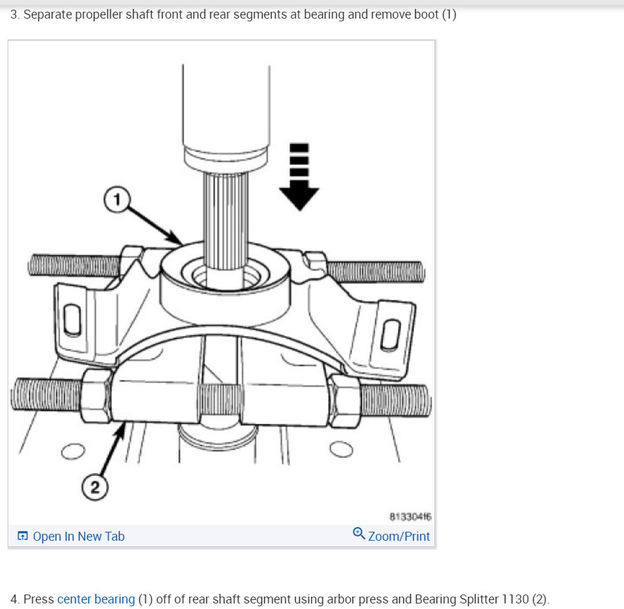

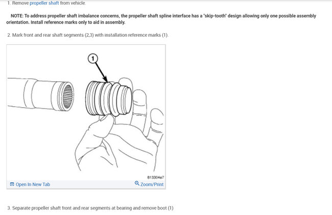

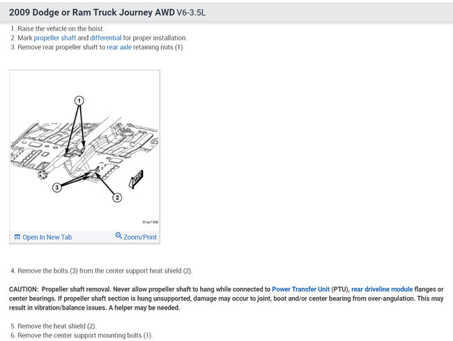

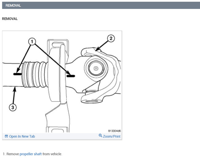

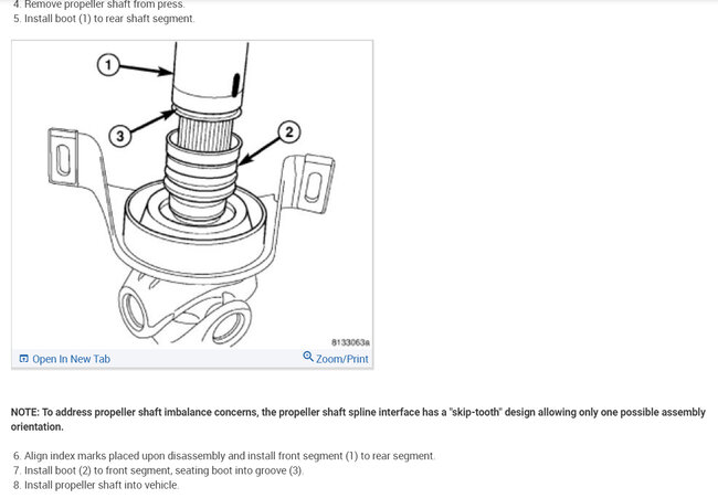

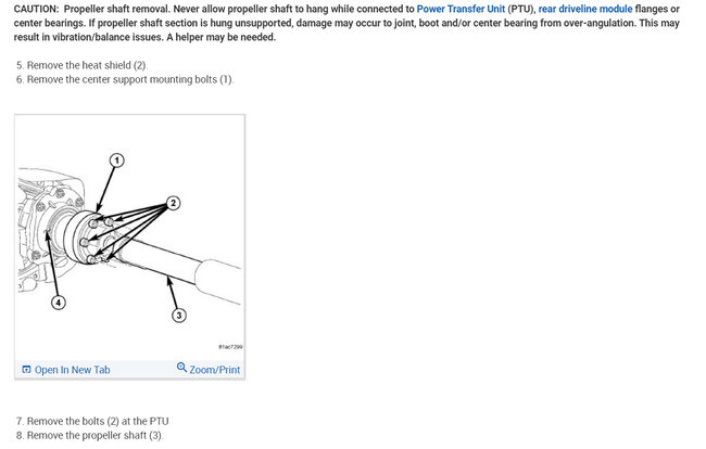

I found that my center carrier bearing needs to be replaced. We've already gotten the driveline off and have come to the issue of not knowing how or where the driveline separates in order to get the carrier barring on. I'm stuck and now that a couple of other hands have gotten involved, I need to replace the whole driveline. But I'd like to know what to do when I get to this part.

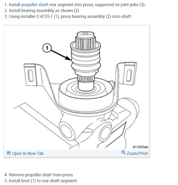

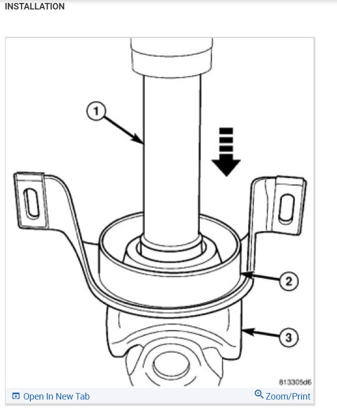

The carrier bearing just hammers off of there, they are not very tight, so you do need to press it. Here are instructions on how to remove and replace the driveshaft. I would check the rubber couplers as well. Check out the images (below). Let us know what happens and please upload pictures or videos of the problem so we can see what's going on.
