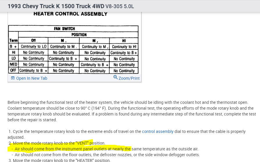

I just need to know the exact name of this panel.

The ones in the center of the dash are called instrument panel outlets or upper panel outlets. Is that what you needed?
There really isn't a specific term. I even went to the manual to confirm that and got what you see below.
See pic below.
