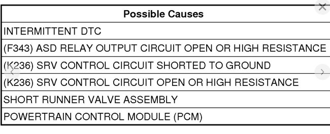

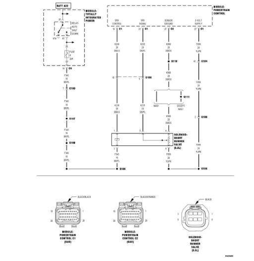

Is it more than likely the actuator that needs to be replaced? The valve does move freely and isn't sticking at all. The car does put off a ticking noise when running and I can feel it when I touch the actuator itself.

Good morning,
It could be the actuator but needs to be verified after confirming the sensor reference voltage and returns.
You need a scan tool to see if you can manually activate the runner to be sure.

Diagnostic Test
1. DTC IS ACTIVE
Turn the ignition on.
With the scan tool, Clear DTCs in the Powertrain Control Module (PCM).
With the scan tool, actuate the SRV Solenoid Control State.
With the scan tool, select View DTCs.
Is the status Active for this DTC?
- Go to 2
- Refer to the *CHECKING FOR AN INTERMITTENT DTC Diagnostic Procedure.See: Computers and Control Systems > Symptom Related Diagnostic Procedures > Checking For An Intermittent DTC

Using the wiring diagram/schematic as a guide, inspect the wiring and connectors between the Short Runner Valve Assembly and the Powertrain Control Module (PCM).
