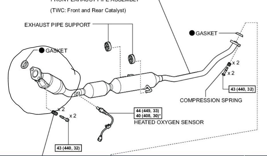

When I accelerate the car it is not moving fast at its desired speed. Catalytic Converter Problem?

Yes, it could be the catalytic converter but needs to be confirmed. A back pressure test needs to be performed to confirm the converter is the issue.
https://www.2carpros.com/articles/engine-has-low-power-output
