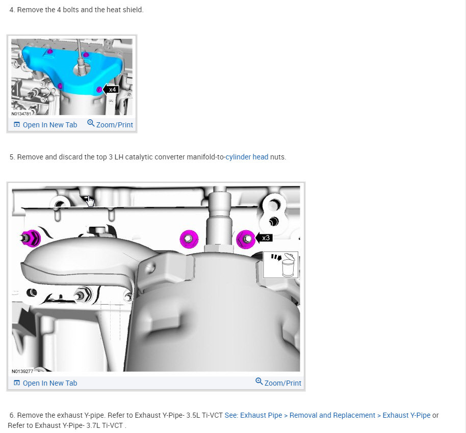

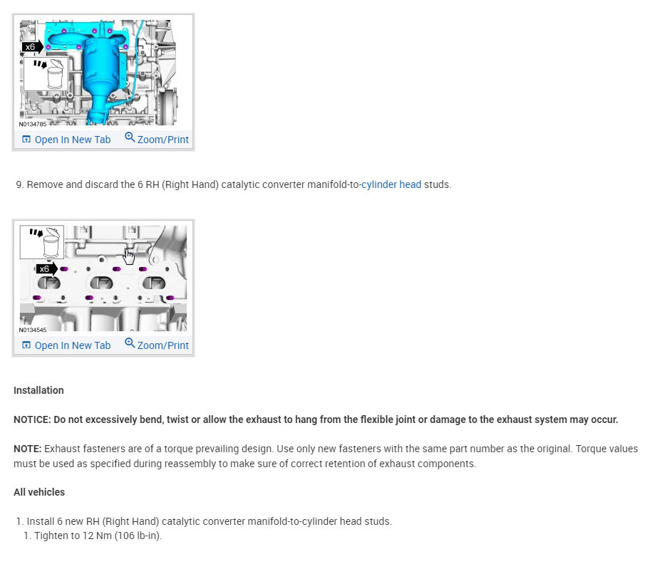

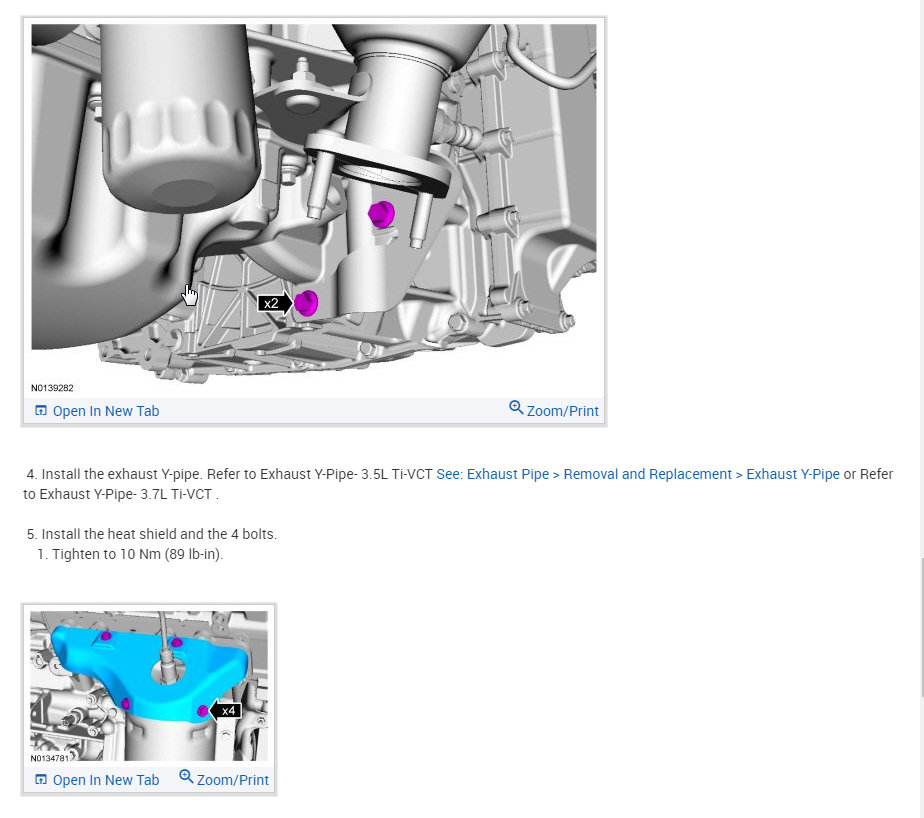

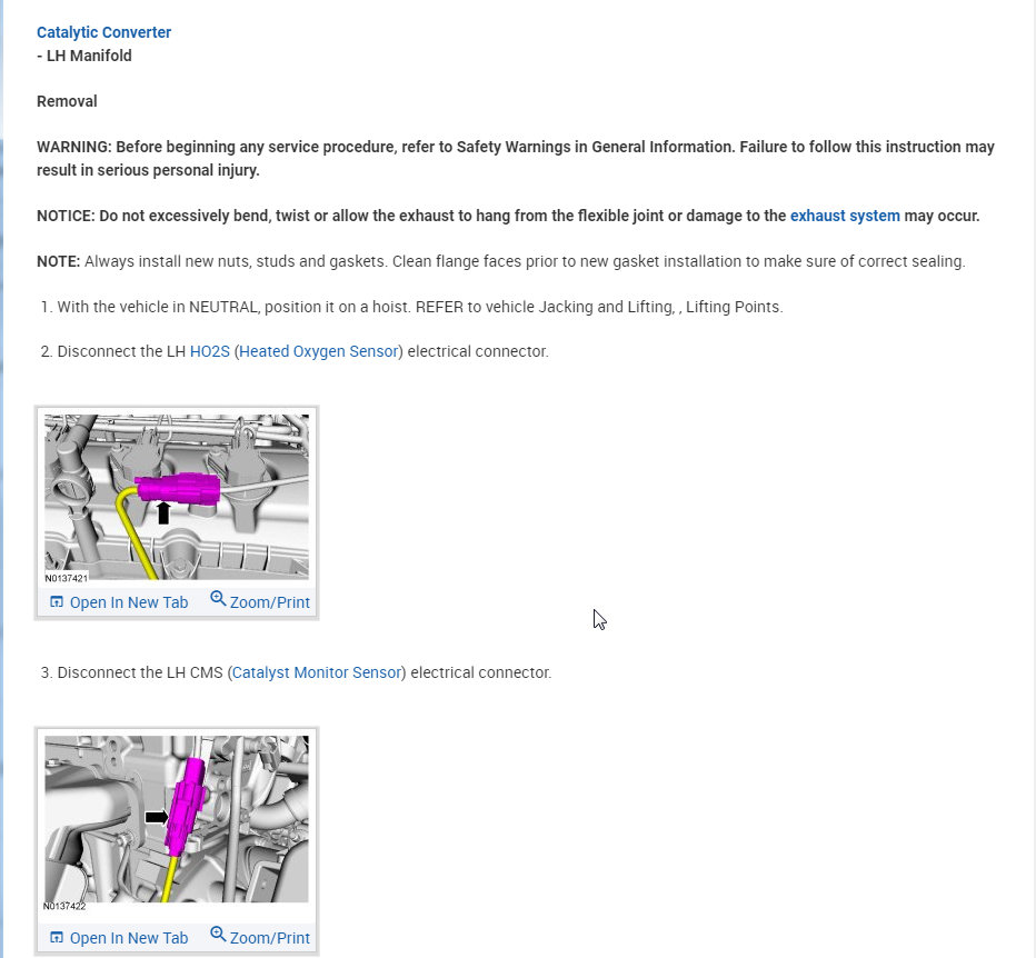

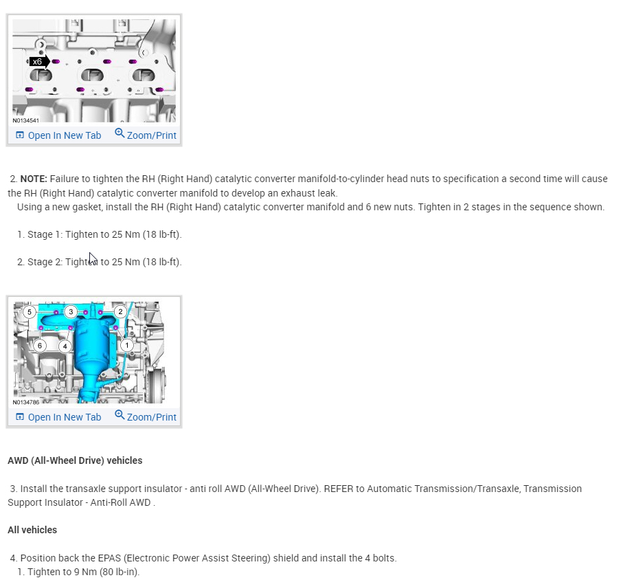

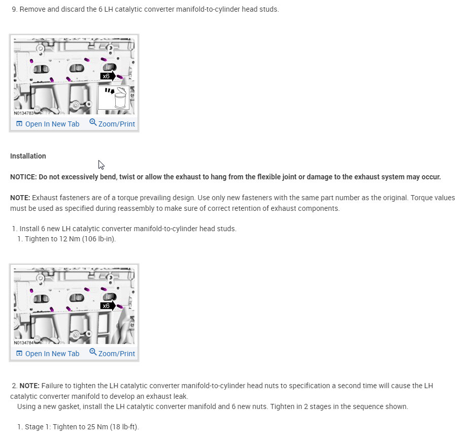

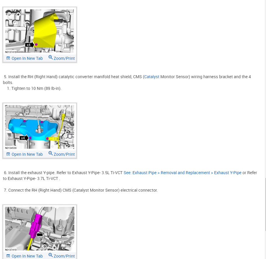

Need to know how many I have and where are they located.
Jul 16, 2019 at 10:09 AM
  • CAR REPAIR CONTRIBUTOR

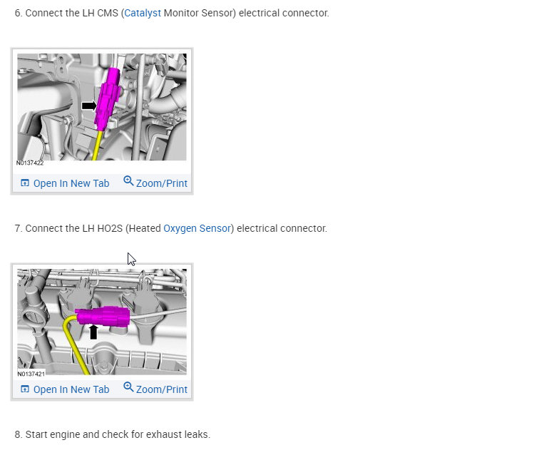

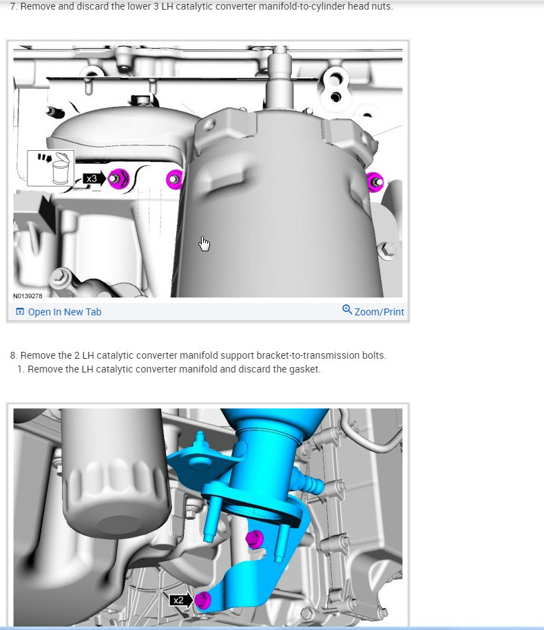

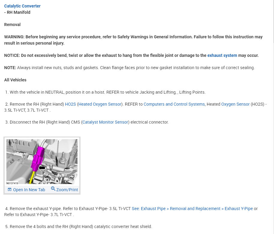

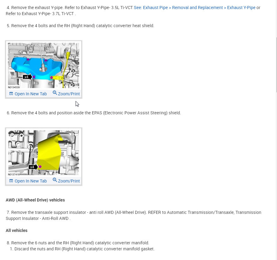

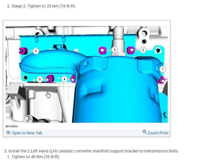

Hi Andrea,
Attached is the process to replace both converters. You have two and they are actually attached to the cylinder heads. You have what are called Converter Manifolds. Normally the exhaust manifolds and converters are separate but not on your vehicle.
Let me know if you need more information. Thanks
