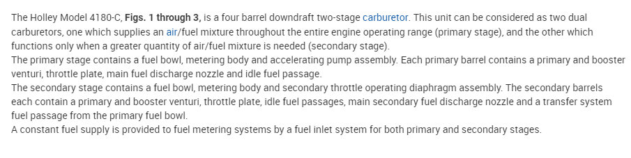

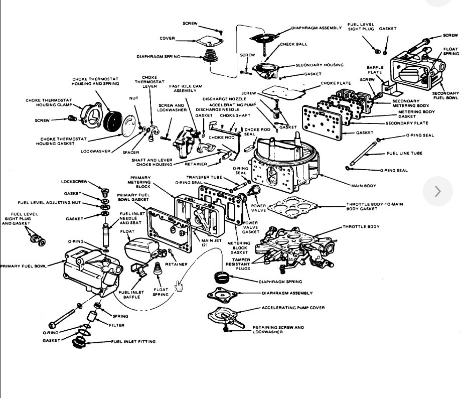

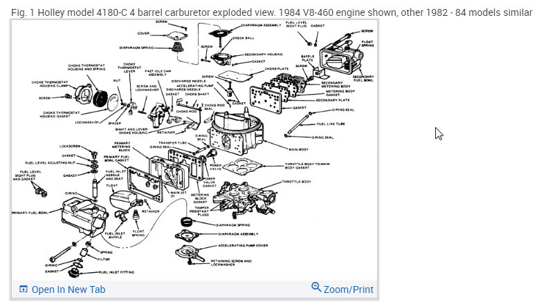

I need to know the carburetor that came stock with my 1984 2350 Kingston motor home with a 460 motor and a C4 transmission.
Friday, August 30th, 2019 AT 2:24 PM
37 Replies
I attached the detail about the 460 carburetor for your model year. Let me know if you need more information. Thanks

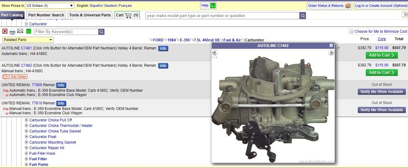

I thank you very much. I've been searching for details about this motor home after but it from a lady that didn't know much. The problem is that it won't go over about 25 mph. I have replaced most of the vacuum lines and the shift modulator. The carburetor that's on it is an Edlebrock 1406 0644, and I don't know a lot about carburetors, but to me it seems some parts are missing? I just looked on line for that Holley carburetor you told me earlier, lmao. Can you tell where I might be able to find a good deal on a rebuilt Holley 4180-c 4bbl? Or something that will work and is easy to adjust. And won't break the bank. Thanks
Friday, August 30th, 2019 AT 5:58 PM
The Holley 4180 was originally meant for 351 CID but worked very well that they fit it to the 460. With this being the case, just make sure you are getting one with the C.
However, the Edlebrock that is on there is a 600 CFM carburetor that is like a cousin to the Holley.
If parts are missing then it may need to be replaced but if a rebuild will correct the issues, that can be done FAR cheaper and is pretty easy.
If you are going to purchase one, I would give one of the sites like Jegs or Summit or the Holley Store, a call and tell them what you have and they should be able to send you everything you need to make it work. Back then, it didn't really matter if it was a motor home our just a pickup truck, the engine was all the same.

Good morning,
Just to add for you, rock auto has the original 4180 in stock for your motor. I attached it on this post for you.

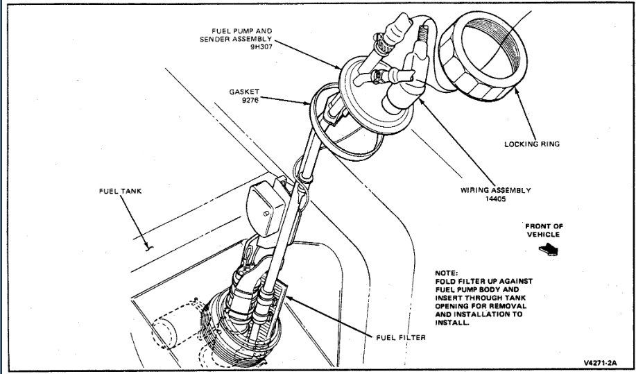

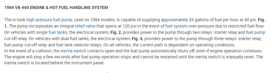

Hi guys, it's hippie again. So I replaced the carburetor with a Holley 600cfm. I got it running at idle real good, when I get drove it the fuel pump went out. (No fuel to carburetor). I know there's no manual pump on the engine (already looked). I found what I believe to be an external electric fuel pump. I also have an on board gen. My question has a few parts to it. First, if that external pump works for the engine, does that eliminate any internal pump. The second part is, How does the gen get its fuel? And for a recap:This is on a 1984 e350 24' Kingston motor home, 460 engine with a C4 transmission. With two fuel tanks. Thanks for any information. Hippie

Here are a couple of diagrams that I found for the fuel system. Looks like it says you have an in tank electric pump. I don't show an external pump or a mechanical pump. So I assume this has been altered due to it being a motor home. However, I will look for the new post and we can dig further into it.

Okay, that's fair. Staying in the external fuel pump. If it has been modified with an external pump, does the fuel typically go through the internal pump as well? Thanks for any information. Hippie

And here's another question concerning having duel tanks. If the pump in the rear tank goes out, could I just run off the front tank?
Friday, September 13th, 2019 AT 10:14 PM
I would expect the in tank pump would still have to work. However if they just put a pick up tube in the tank then clearly it would not because it wouldn’t be there any more. I don’t think the in tank pump can be used as just a pick up meaning it’s just like a tube in the tank that draws the fuel out. I think the pump would have to work so the only real way to know is to see what’s in there. Anytime something appears to have been modified it’s best to just investigate it and see what is there.
Yes. You can run off of just one tank. I had an F150 with duel tanks and the rear pump went out so I just ran off the front for a while. Only issue is you have a smaller tank. But this is why Ford went to this is so that you have a back up for when a pump went out. You should have a tank switch that allows you to select which tank to run off of.
